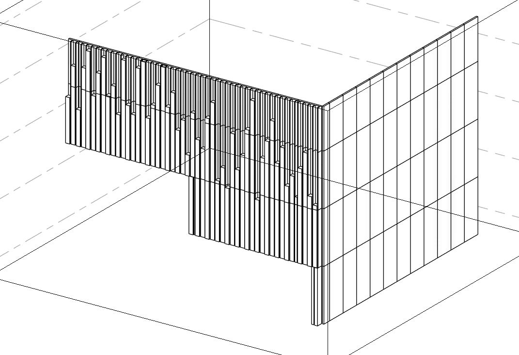

I am working on creating GRC panels in Grasshopper to place into a curtain wall in Revit. I have followed the solution provided by @Japhy in the topic linked below. Everything works well, except for panels that lie on a cut grid cell (grid cells where the panel has a non-rectangular shape or more than four sides).
I have created a sample file attached below to illustrate the issue. As shown in the attached image, the panels are created and placed correctly except for those on cut grid cells. I get the error shown then the panels dont get placed.
Does anyone have any ideas on what could be causing this issue?

Hi Clayden,
That is a known limitation on edited curtain wall profiles. Typically people use a Wall or an Adaptive Family in those situations. Another option would be to have a non-edited wall and
use the custom families there.
Hey Japhy,
Thanks for the quick reply and links! guess i gotta freshen up my revit skills a bit. But yeah I’ll mostly reset the profile of the curtain wall and either cut with a mass or have the panels smaller in those areas.
Thanks again…
