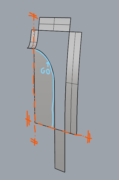

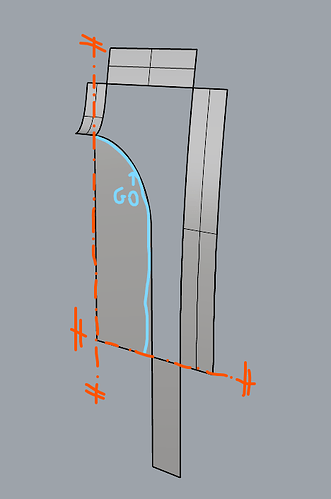

Good morning everyone,
I’m trying to fill this 5-sided hole.
What I’m looking for is a position match along the sky blue edge I marked, and some sort of tangent/curvature continuity with all the other edges.
This is just a quarter of the final shape I’m trying to model, so the eventual result would have to be mirrored twice.
My understanding is that in scenarios like this one, what I should aim to do is to break down the 5-sided hole into two 4-sided “patches” by using some internal curves and then try to match everything. But I might as well have gotten it all wrong.
That said, I unsuccessfully tried to do that, and I also tried to make the patch in one go with xNurbs, but the result straight out of the tool was not what I’m searching.
I’m also attaching the file, any help or advice is greatly appreciated. Thanks! :slight_smile:
5 Sided hole question.3dm (488.8 KB)

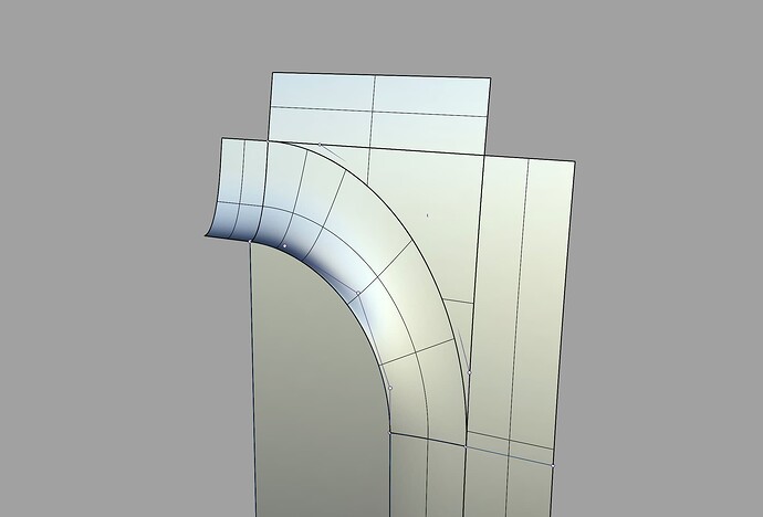

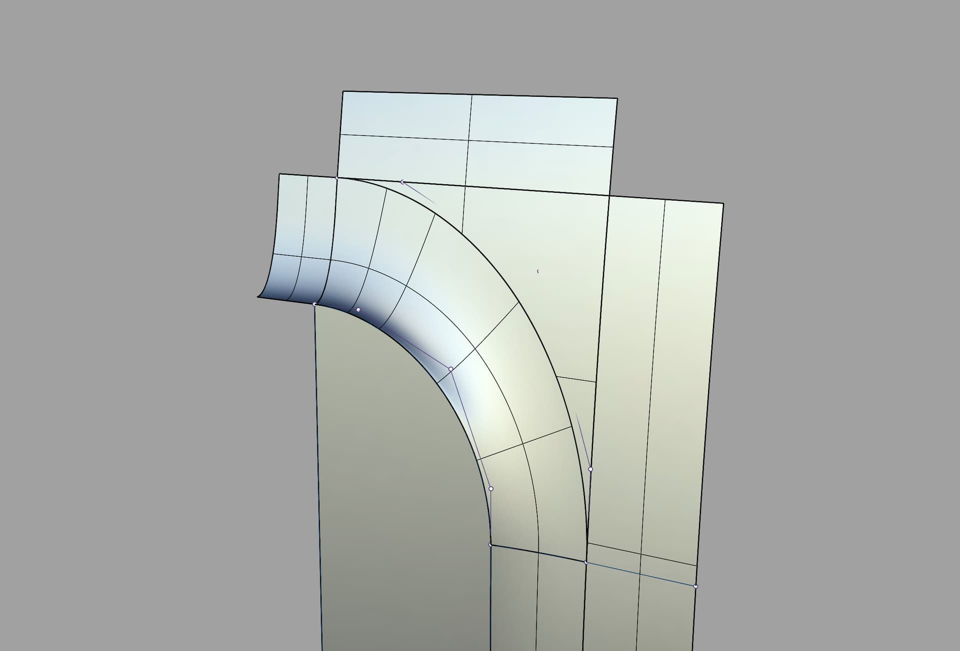

One issue is that the arc used to trim the quarter circle has a kink (an edit point with multiplicity). I replaced it with a proper curve (degree 3, 2 spans). Here’s the standard patch layout of doing these kind of things (I only did it with G0/G1 continuity).
5 Sided hole question.3dm (3.1 MB)

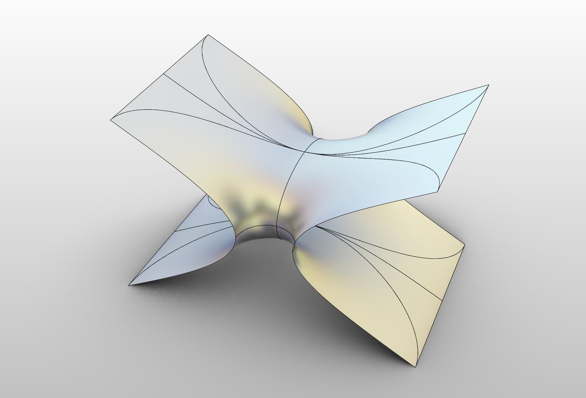

That’s correct. Can you post this file here? It’s an interesting case.
Here you go. It’s a student exercise I have often used.
Minimal surface from five edges.3dm (207.6 KB)
How good is the new Rhino V9 Patch tool with this example?
No idea. I just started with V8.
This means that you are lucky to have access to Rhino 9 WIP to try the new features there. :slight_smile:
