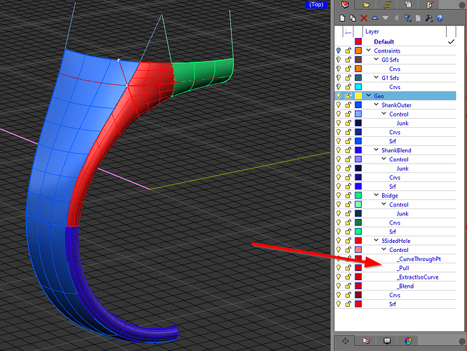

Best patch layout for this 5 sided hole?

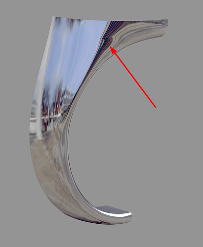

I have a 5 sided hole I struggle with. I can’t seem to find the right patch layout where this area is smooth:

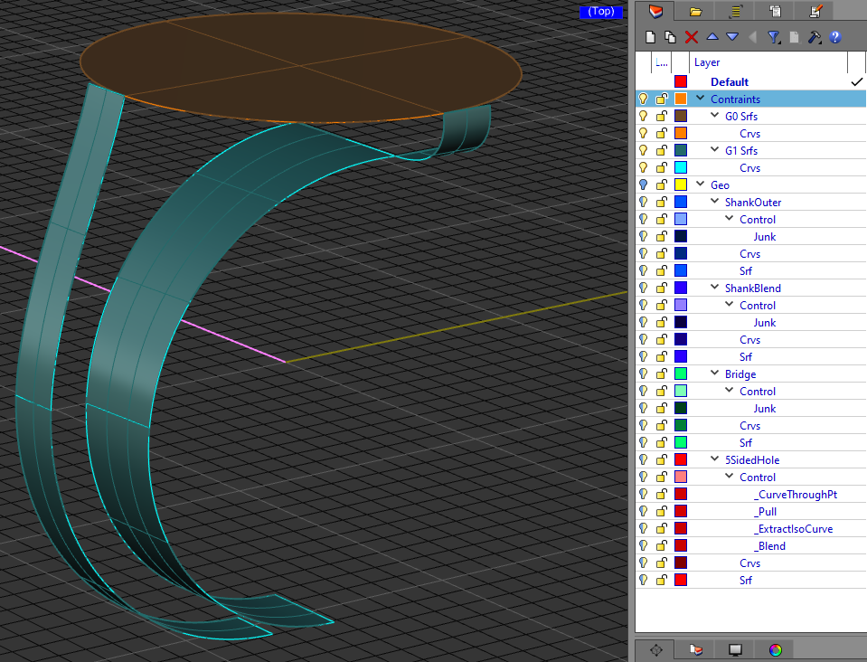

My attempt is attached below. The constraints are fairly fixed but simple. There are some orange/brown G0 srfs to match and some cyan/blue G1 srfs to match:
The file utilizes a fair amount of history. I tried to label some of the layers to help you identify how something was made.
