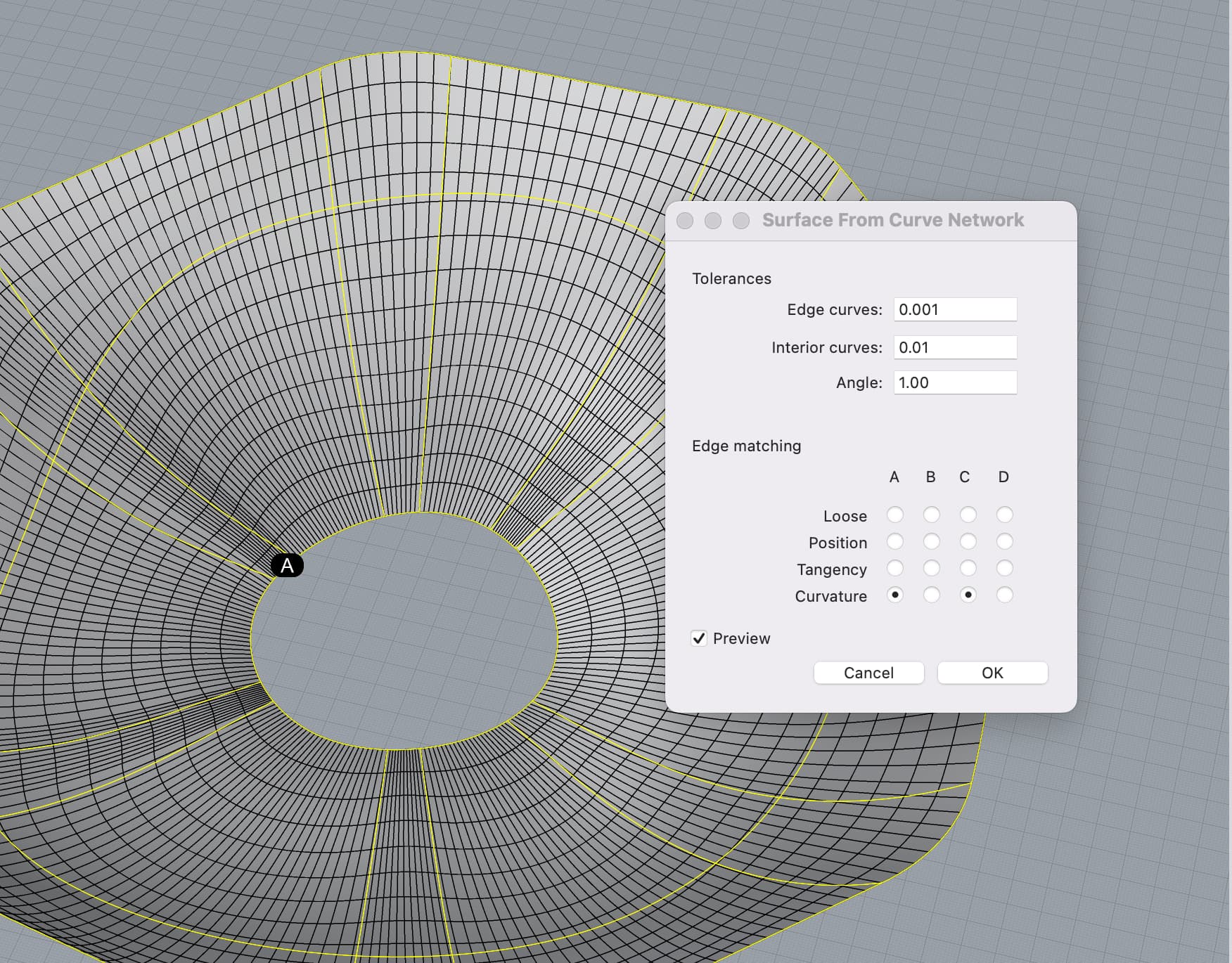

I’ve managed to complete the first part
However I am struggling with the ’ i decided where the transition to a fully convex section will happen vertically (i intersected a plane with the profiles) and made an interpolated curve. i did the same for the bottom endpoints ’
I’ve done interplating curve on surface but not curve on curve if I’m understanding correctly. How do I go about intersecting a plane with the profiles please?
Best
B :slight_smile:
Hi Adel
Sorry, I misunderstood! I’ve since intersected a curve across the profiles by using a plane like you said. I’ve used the command network surface and my surface is not looking right. Please see below.
All help is greatly appreciated!
Help file 2.3dm (345.7 KB)
Best B
hi B. Network surface creates approximate surfaces based on the curves you input. if you want an exact match between the curves and the surface, your best bet is to use sweep2
so based on your help2 file, here’s what you should do
  1. explode the purpe curve. you should have the corner fillets as separate curves
  2. split the bottom interpolated curve by the profiles. you should get this. (hint: best practice after splitting is to rebuild your curves to be of degree 3 and point count 4)
  3. blend the bottom curves to make sure they are tangentially continuous
    check the options in the prompt of BlendCurve
    you should get this
  4. here is where you need to decide where the transition from a concave curvature to a fully convex one needs to happen.
    to explain this a bit, consider how the highlighted curves in the screenshot are curved outwards (sometimes this is subtle)
    in any case, use a plane to decide. if the plane is high, the transition happens faster, if the plane is low, it happens more gradually.
    and intersect that plane with the corner profiles to create the points for the interpolated curve
  5. create the interpolated curve using the intersection points and then split it using the corner profiles
    you should get this
  6. create the surfaces of the fillets. we start with this ones because they are all convex. here, use sweep2 with the profiles as rails and the top, mid and bottom curves as profiles
  7. use the corner surface edges as rails and the top, mid, bottom curves as sweep2 profiles. in the dialog, make sure the edges are tangentially continuous (in the edge continuity section)
  8. join all the surfaces to get this result
    in rendered view you should see this
    as a final check, use the zebra command to check that tangency is not broken
  9. study the file i attached to this post for reference
  10. be happy and productive!
    Help file 2[completed].3dm (758.5 KB)
