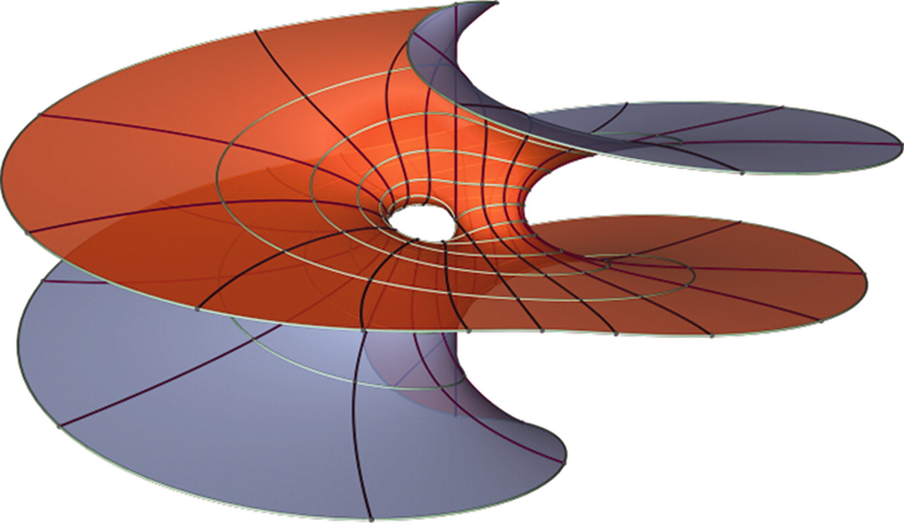

HI i’d like make attached thing
a
b
when i do with spiral after punching hole, it wont be the same
At the attached thing, the hole seems to be under the purple floor
slope should be adjusted by tspline?
Or anyone can make that stuff using formula by grasshopper… ect please notify
thanks!

i’m architecture student and i’m serching for a unit
i got costa surface obj but i need transform a thickness of Column or size of the hole etc…So i need it by grasshopper script
i dont care if it is brep or mesh

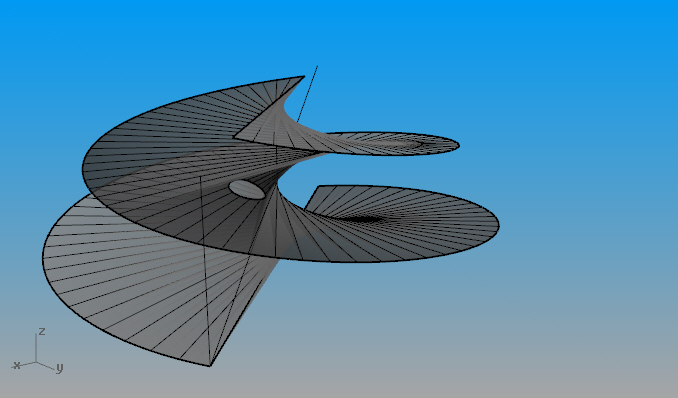

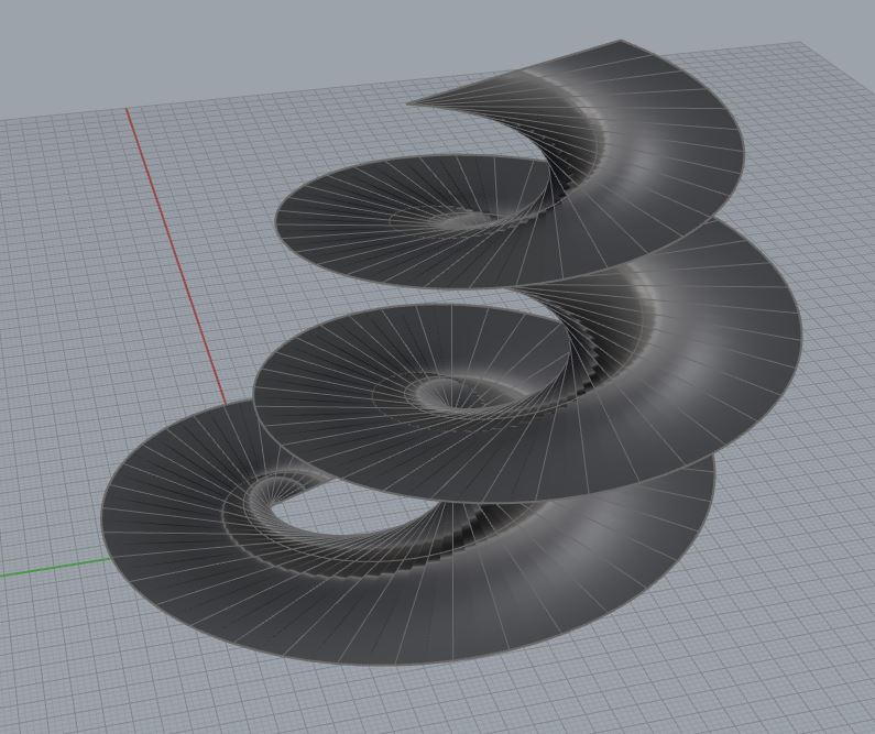

Distorted Helix.3dm (207.9 KB)
Method to create distorted helical surface in Rhino.
First create an undistorted surface.
Helix for helical curve which will be inner edge of surface
Helix for helical curve which will be outer edge of surface
The axis need to coincide and be the same length.
The number of turns/pitch needs to be the same.
Radius is different.
Orientation of the starting point of the helix can be different.
Loft between the curves to create the undistorted surface.
If a different shape is desired try rotating one edge curve about the helix axis and use Loft again.
Distort the surface.
Cage with BoundingBox option.
Number of x points and y points = 2. Number of z points = 3 or more. (I used 4 z points.)
CageEdit the helical surface using the Cage as the control object.
Move sets of four points with the same z elevation together to keep the helix “circular”.
