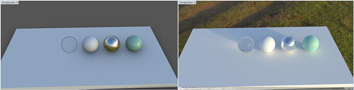

I always find Rhino to handle the HDRI lighting as a low range light dome. Is there a bug there? As I can never seem to reproduce the HDRI lighting in any HDRI lights out there on the market.
This relates to both Raytraced and Rendered, so it must be at the core some where.
Take a look at this example image from HDRIHaven compared to how Rhino handles the same light. (That is not a sunny morning there in Rhino… it’s pretty dull and overcast if you ask me):

I don’t know about Rendered mode, but for Raytraced I have a bug logged for this: RH-61976 HDRi with high dynamic EV are underpowered in Rhino Cycles.
Good, but it seems to be more than just underlit, it seems to be converted to a much narrower range.
If you compare the reflection in the chrome spheres in the image above you’ll see that in Rhino the sun burns out more too. And the shadows are way to soft. (At least I don’t think that an extra directional light is added to the HDRIHaven image, based on looking at other sample images from other HDRI’s from them)
Underlit is I guess in laymans terms what you describe (:
The HDRi with high EV should be equivalent to very bright sun.
OK, I think of underlit as using a too low multiplier. (Like underexposed on the camera side)
I changed underlit to underpowered in the YT item.

RH-61976 is fixed in the latest Rhino 7.7 Service Release

Hi guys, just did a test and This is very promising!
I had to set Gamma to 1.2 to get a descent result, could you check if it that is the correct setting, or if Rhino should adjust something to compensate for that?
Rhino 7 latest official SR at Gamma 1.0:
Release Candidate at Gamma 1.0:
Release Candidate at Gamma 1.2:
Thanks!
Just so you know, this regards Raytraced and not Rendered mode:
Here compared side by side with Gamma = 1.0:
And here Gamma = 1.2 for both views:

I understand that this is confusing because now I am trying to replicate it on another machine with a different HDRI and here the lighting looks the same in Rendered and Raytraced, so I need to double check that both display modes uses the same settings for background etc. (that stuff isn’t 100% intuitive so I might have changed something)
But now on this machine when I lower the environment hdri strength then the Raytraced viewport background is darker than the Rendered background:
Here I used Background = Use Render Settings for both.
If I select Use Application Settings then the Raytraced mode is still darker than Rendered:
But the lighting and the shadows from the HDRI are really nice and crisp though! So thanks for that great work!
