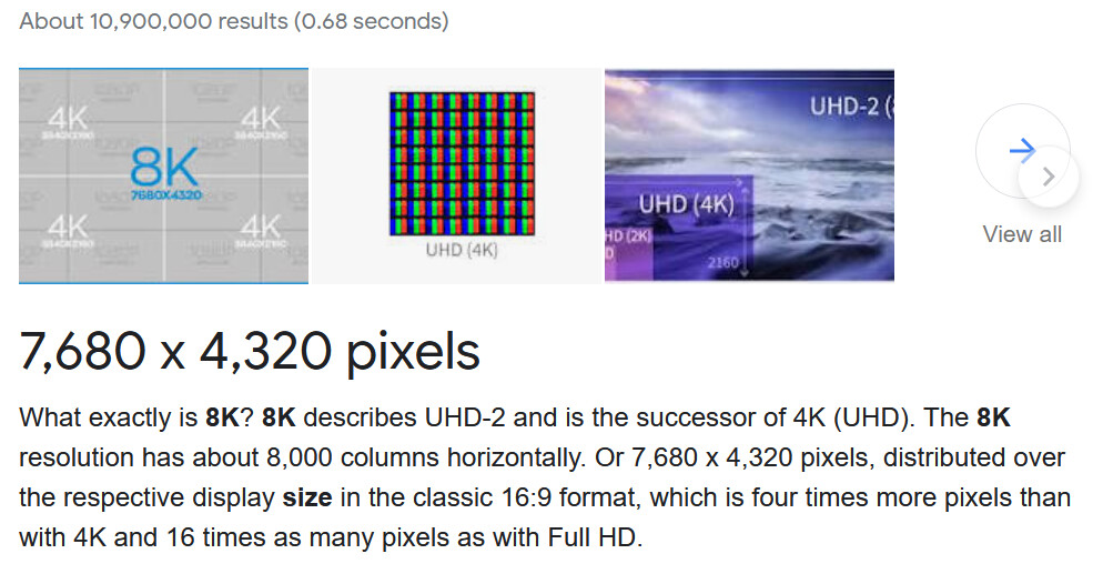

  1. With a 8k HDRI I need to input 7680 value into Tex. Resolution right?

Yes and No, this parameter is for importance sampling algorithm defined as below:
Tex. Resolution – Specifies the texture resampling dimensions for importance sampling in order to produce better shadows without affecting how the texture itself is rendered. This parameter does not work with V-Ray GPU. Instead, the texture resolution is resized to the specified amount.

Why do we need to use 7680 for 8k HDRI but 8192 for 8k textures (in displacement channel for example)
We use HDRI for lighting, we don’t really care about the sharpness of light, if the light is soft and blurry it is not a problem, but for displacement, a low-resolution displacement texture will result in a very jagged geometry

Understood. Although I was referring to the apparent mismatch between 8k dimensions:
8k HDRI (I guess)
8k Textures
I have, but not really, I just generated a couple of scenarios and could not find a way to save/load one of mine so I closed the window and never opened it again.
Yes the terms 2k, 4k and 8k are general terms to describe approximately the width of the image in pixels. Assuming more devices are now with the aspect ration of 16:9… That’s not the case in HDR when it is mostly either square (1:1) ratio or half squared (1:2).
1:1 is usually spherical environment maps
1:2 is usually hemispherical maps
8 kilo pixels = 8 x 1024 = 8096 pixels
1024 is that computer science thing to make things complex.
