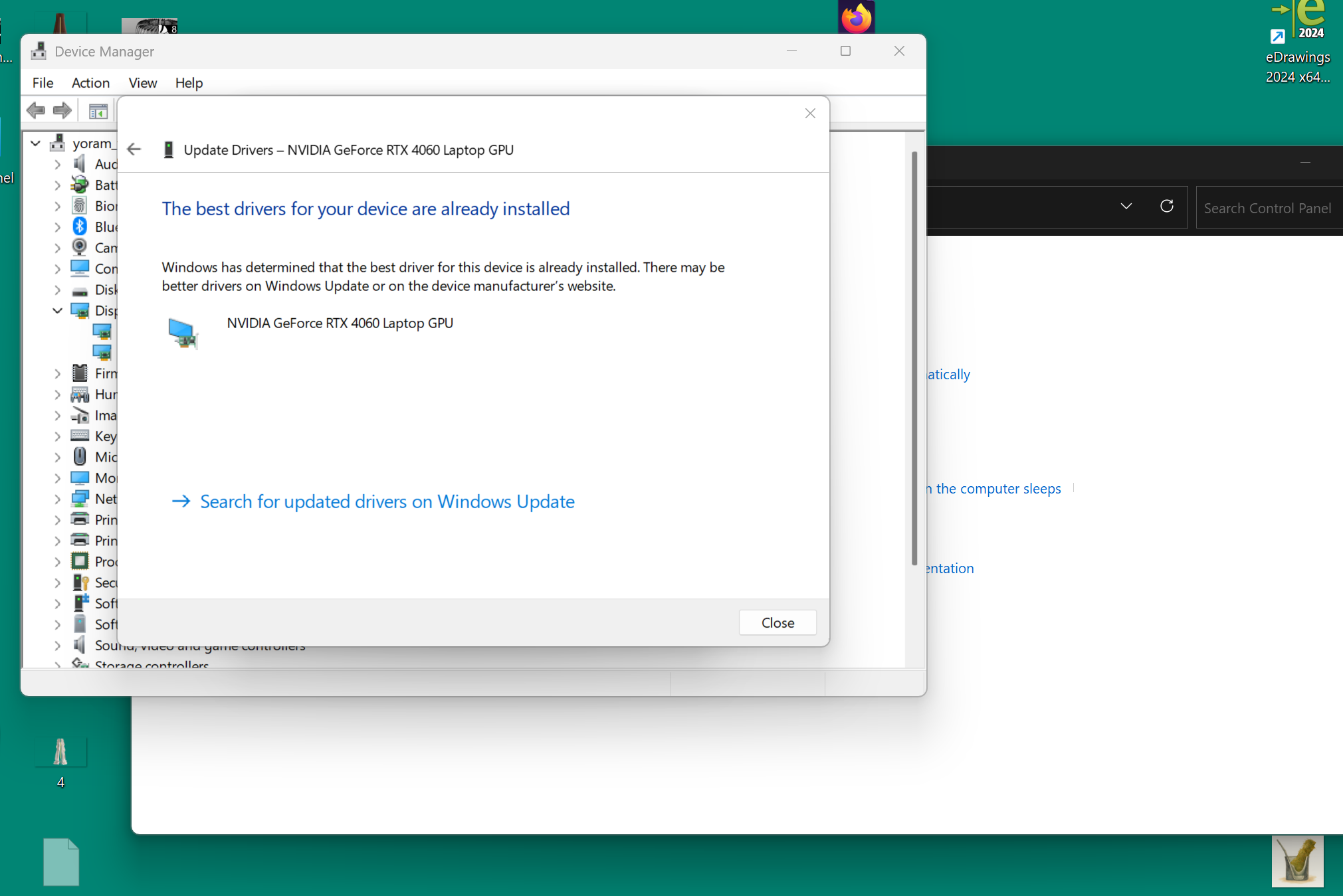

So, first thing is: your drivers are not up to date (Windows reports they are because it only has outdated ones in its stash). Go to your laptop manufacturer’s support site and see if they have later ones. You can then go to intel and Nvidia for the absolute latest. With some laptops there can be specific integrations that require the manufacturer version, so be prepared to back Intel or Nvidia ones out if something breaks (e.g. I have a Surface Book with a detachable screen and I have to use ancient Microsoft drivers).

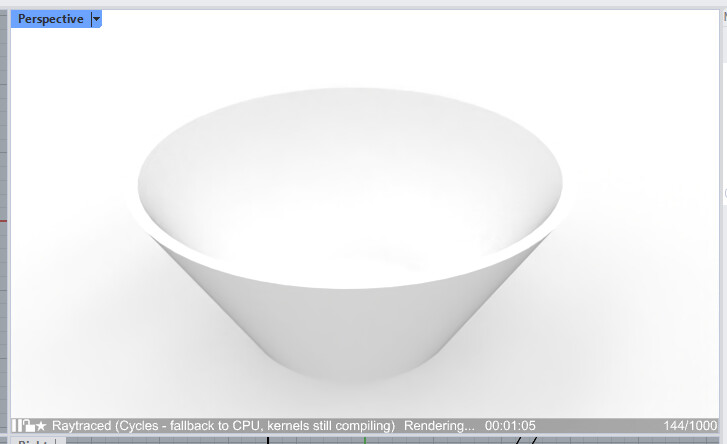

Here’s a question that could have been asked sooner: is this the first Rhino render you have attempted on this machine?
AFAIK the first time you use the Rhino cycles renderer after a Rhino install, the render engine prepares itself to run on that system. That preparation takes a significant time. If you cancel the render before it is completed then cycles will have to start the preparation afresh the next time.
If you see a message along the lines of “compiling kernels” in the progress bar at the bottom of the render window, that is what is going on. Go grab a coffee, go out to dinner if necessary, but leave it to finish. Your next render will complete without the lengthy preamble.
Let us know if this is what is happening with you.

addendum: if you have selected a GPU as render device, but the kernels aren’t ready yet when you start rendering, or switch to raytraced in a viewport you’ll see a clear mention of that. In the render window in the title bar, for the viewport in the hud like this:
Hi guys thanks for all the good support, since last time I could advance really good and got information how to work faster and more efficient, first of all instead of working in mesh I converted all component to nurbs so it’s converted to mesh only before rendering and now the file work better,
Second, found out that working in shaded mode is way better than rendered… dahhh!
Third updating the driver helped me and now the render work significantly better,
