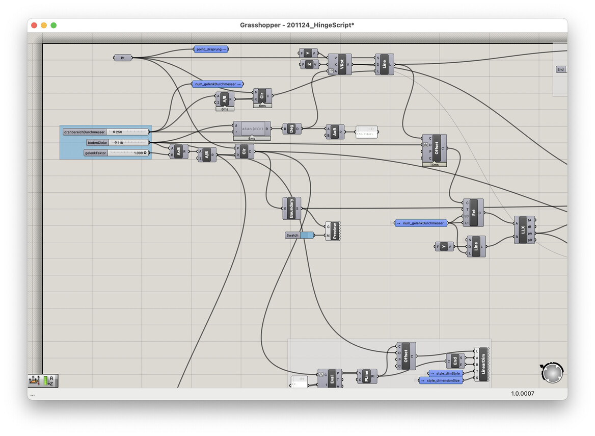

just download the newest 7.1 RC… here is my minimalistic take for the canvas :heart:
Just a small update:
Component tabs seems to be the major bottleneck now - removing them makes the gh-canvas responsive af.
This minimalism of the UI is just beautiful…
