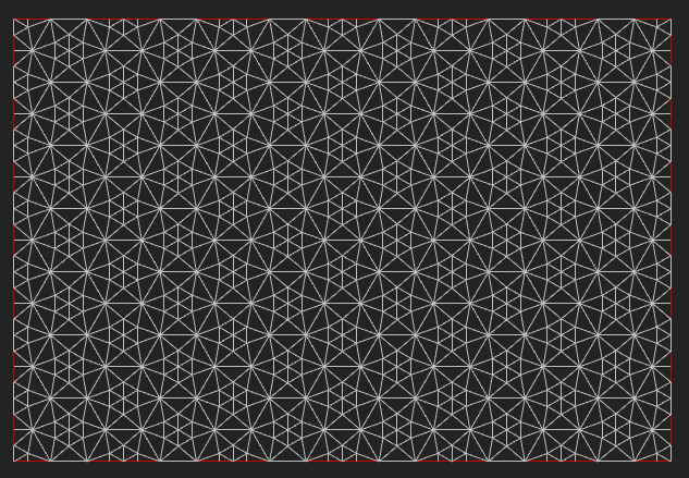

Hi, if anyone could help me out that would be amazing! I am trying to create a geometric pattern based on the cuts of some diamonds, akin to the images attached below except with offsets all around, which I can then manipulate with attractors or hopefully even image attractors … (if I figure out how!)

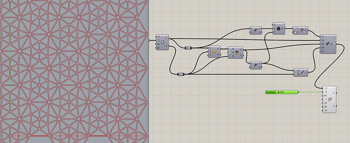

I cant seem to get the points from the original hexagon to link with the offset rotated one using polyline, so i just used line and join one by one … however the final offsets are not working out at all! any help would be much appreciated.

You can start with this and you need Clipper to create the offset
hex_hex.gh (11.9 KB)
ah yes thank you, that is exactly what I’m looking for! now to try the image attractor!
