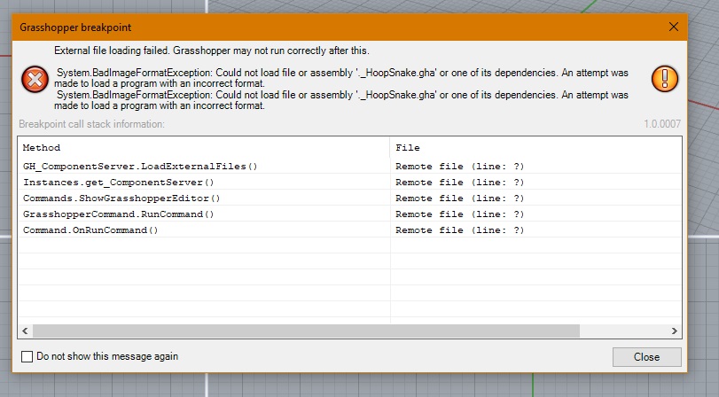

I encountered the blank canvas issue today. After this message was shown in Rhino 6, Grassshopper appeared with no component.
What should I do to retrieve the lost components?
Remove hoopsnake I think

Can you run the GrasshopperLoadOneByOne command and just say ânoâ to all plugins. Then slowly bring them into the fold until it fails?
There was no option to choose
The LoadOneByOne command asks before loading each plugin. You can choose to either load it or not. If it doesnât show a string of message windows something is going very wrong very early in the loading process.
What exactly are you seeing after running the Grasshopper or GrassLoadOneByOne commands?

I am seeing the same problem with an error and blank GH toolbar. I just tried the Rhino 6 install (first time - Iâve had Rhino 5 for some time now) and it seemed just fine. But when I run Grasshopper in Rhino 6 I get an error and a blank toolbar?
When I run âGrasshopperLoadOneByOneâ I get the exact same result as when I run âGrasshopperâ (it doesnât ask me anything, just gives the error and goes to a blank toolbar). My error shows:
I have no idea where _excelreadwrite.gha is though? Its not in my âComponentsâ or âUser Object Folderâ? Its some old plugin Iâd downloaded and tried back in Rhino 5 months ago but I thought Iâd gotten rid of it ages ago.

Can you run a full search on your entire drive for all files with a GHA extension?
In the meantime Iâm looking into what might be causing this exact error.
As a test, can you move all the files and folders from the C:\Users\edpma\AppData\Roaming\Grasshopper\Libraries into a folder elsewhere and try loading again?
Note that both @Kevin_Saslawsky and @ed.p.may errors are regarding plugins with a dot-underbar prefix, i.e. ._HoopSnake.gha and ._excelreadwrite.gha respectively.
This indicates something strange is going on. Apparently this prefix is associated with shared volumes⌠link1, link2
So searching a local disk may not in fact sufficeâŚ
Hi @DavidRutten,
Thank for your response.
As you suggested, I went back and did a more thorough search and was able to find that âunderscoreâ file after all (in my case, _excelreadwrite.gha). Turns out it was a âhiddenâ file inside my .../AppData/Roaming/Grasshopper/Libraries/... folder.
It must have been created / added by the plugin somehow and when I removed the pluginâs unhidden .gha file from that directory, that âhiddenâ file stayed behind.
Once I removed that âhiddenâ underscore file from my library folder everything in my new Rhino 6 Install booted up normally and successfully.
