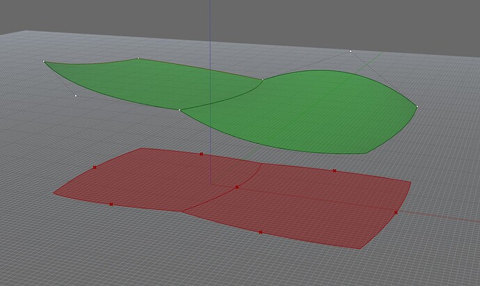

How can I make this work?
I have the curves sorted in lists as shown and have to make this work for some 20 items per list.
I´m sure it´s rather simple but can´t wrap my head around it.

I have simplified my problem too much. Some of the shapes overlap with identical curves one on top of each other like this:

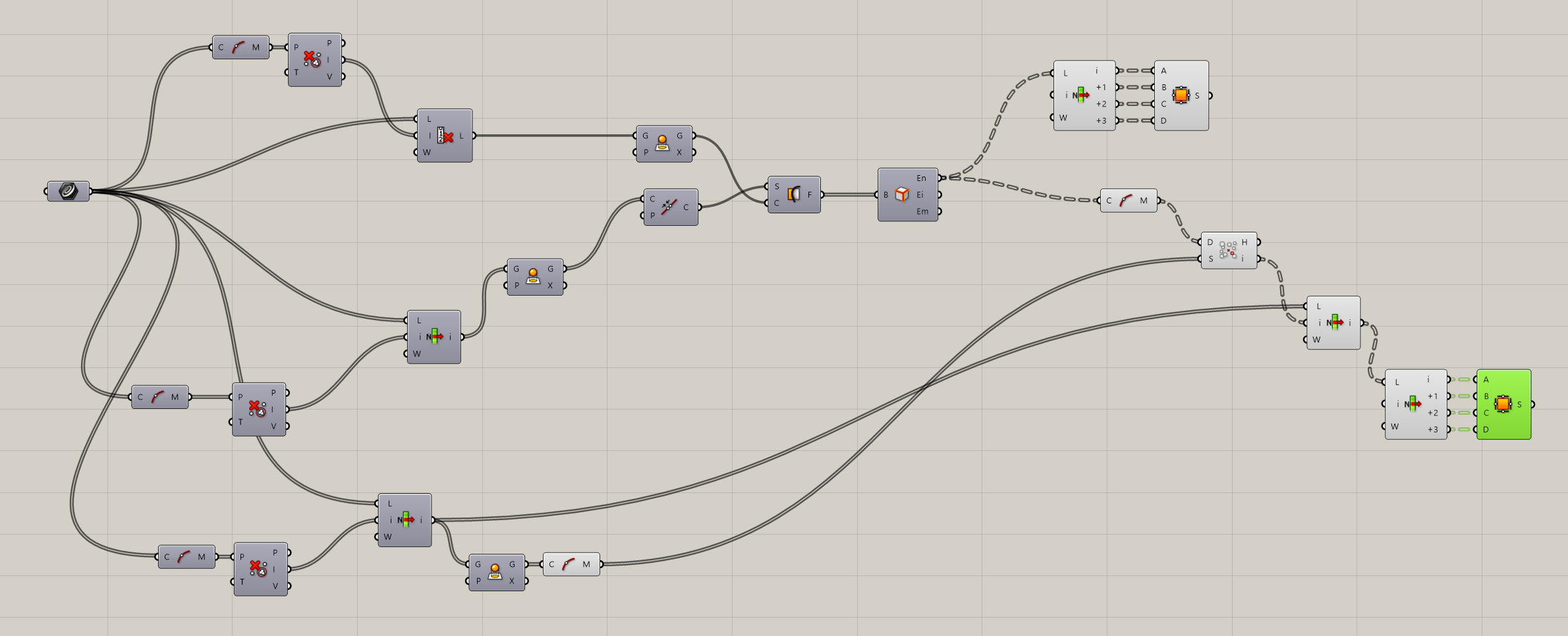

Not at all, sorry I can´t share the company files. :confused: You can imagine something like 2 or 3 curved “ladders”. There are alvays 4 simple nonplanar curves divided as shown - two go into V and two go into U. I believe this is a tree management excersise which is something I suck at big time.
I can get individual “windows” this way:
I believe I need to branch the sets corectly to organise them into these “pairs”. Random combinations of grafts and flattens didn´t work (unexpectedly) so I´m reaching for help here.

This is embarrassing – I really did think this is a stupid simple problem so I didn´t include a properly made example file. I slept on it and came back thinking it obviously is a more complex problem based on the propoused solutions kindly provided by Martin S. I have actually prepared the proper sample. While doing so I figured out the solution …
