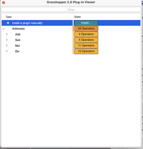

I am experiencing an issue with Grasshopper 2 on Mac. Despite trying different versions, it is still not working. Additionally, the command window does not show any errors or any other information.
Rhino version is 8.15.24352.13002, 2024-12-17
Grasshopper2: 2.0.9040
@hamidpeiro pls run _SystemInfo in Rhino and post back the result.

Can you run the _G2PluginViewer command before trying to start Grasshopper? Then manually load each plugin by clicking on the Scoped buttons?
I tried this method, but I am unable to click on the buttons.
So GH2 isn’t finding any of the plugins. Very early failure then. It’s supposed to look like this:
Can you navigate to the folder where GH2 was installed by the package manager and see if there’s any of those rhp files visible in my screenshot there? (I have no idea where PackageManager installs stuff on Mac, you may have to search your entire drive for Grasshopper2.dll)
