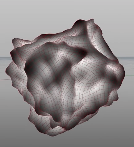

Hi! Im trying to make a color gradient depending on the distance of the center point of a sphere to the points of a deconstructed mesh. The idea is to have something similar as it is shown on the photo! Can anybody help me out please? I have been trying but havent made it to the result, just a beginner of grasshopper!
Screenshot 2023-11-22 at 18.22.31
