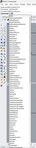

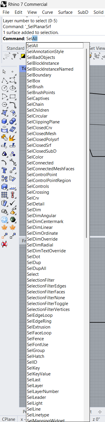

Hi @Steve1
Is Rhino’s intelisense not working for you?
When I type sel at the command line I get a huge drop down of sel commands
If I type selp then all sel commands pop up with p in them.
This is in V7 I think V5 has intelisense too.

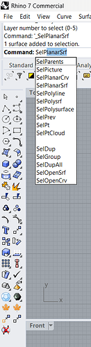

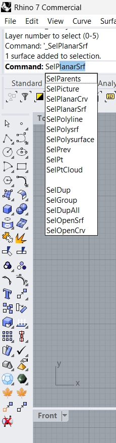

It helps, but sometimes a command is named nothing like what it does !
In this occasion selp shows selectPlanarSrf and it found the four that prompted ne to search for more, so they were the only escapees.
