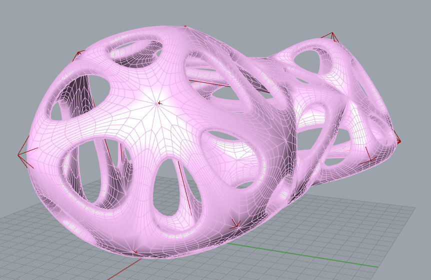

Thank you! I didn’t know it can be so easy to create something like that. I just tried it and got this result:
I still feel like it’s not organic and smooth enough, there are too many edges. Also, I think the holes look a bit like just spots on the base shape, and not really like showing the skeleton. Are there ways to improve that?

you can try modifying the parameters of Weaverbird in the definition.
Your other option is multipipe in grasshopper too, you can do a lot.
There are many many ways to smooth the mesh.
As said by @Davide3 Multipipe is a good one
Dendro could also be used to generate the mesh or to smooth it.
Working on smmothing curve network is also a solution
Without smoothing the network

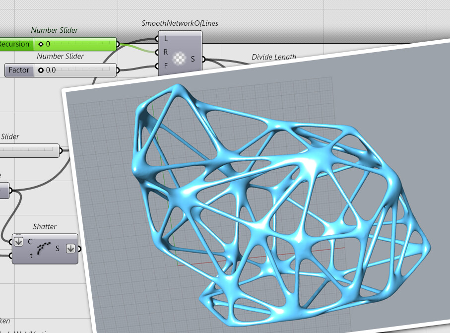

With one of my tool (not yet published as a plugin), I hope Daniel one do the same thing
Thanks a lot! Your creations look very beautiful! Could you please share the files? :slight_smile:
The only change from your definition is the smoothing of lines. So upload @DanielPiker tool to smooth a network and use the output instead of straight lines.

you’ll have to better understand how components works. For example you use the “out” from Daniel Script, you must here use “A”. If you don’t know where is the output plug a panel at the outside, or a geometry component.
Test things on small parts. Now that I have tested Daniel script I saw that it is not good on this kind of topology without Dead Ends because the network will at the end become a point.
So you’ll have to have dead ends.
smooth network of lines then mesh it LD.gh (164.7 KB)
So first
Extract your network (no dead ends)
Add some dead ends, not useful with my not plublished plugin (I plan to make it available with many more components)
Smooth the network with Daniel @DanielPiker tool, not too much itteration because it shrink
Remove dead ends with the script I did there for you
Then use your favorite meshing program, don’t forget to click on the triangle on data dam
