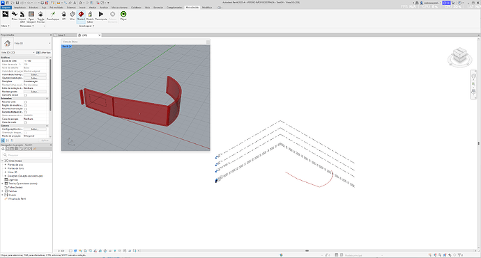

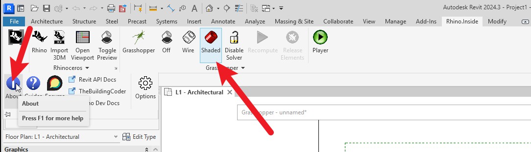

Hello!
I installed Rhino.Inside Revit on Revit 2026 and when I try to create objects with Grasshopper, I can see the object in Rhino but not in Revit.
As an example, when creating a Wall by Curve, in Rhino I can see the wall but in Revit all I can see is the curve used to create the wall.
Anyone is having this issue?

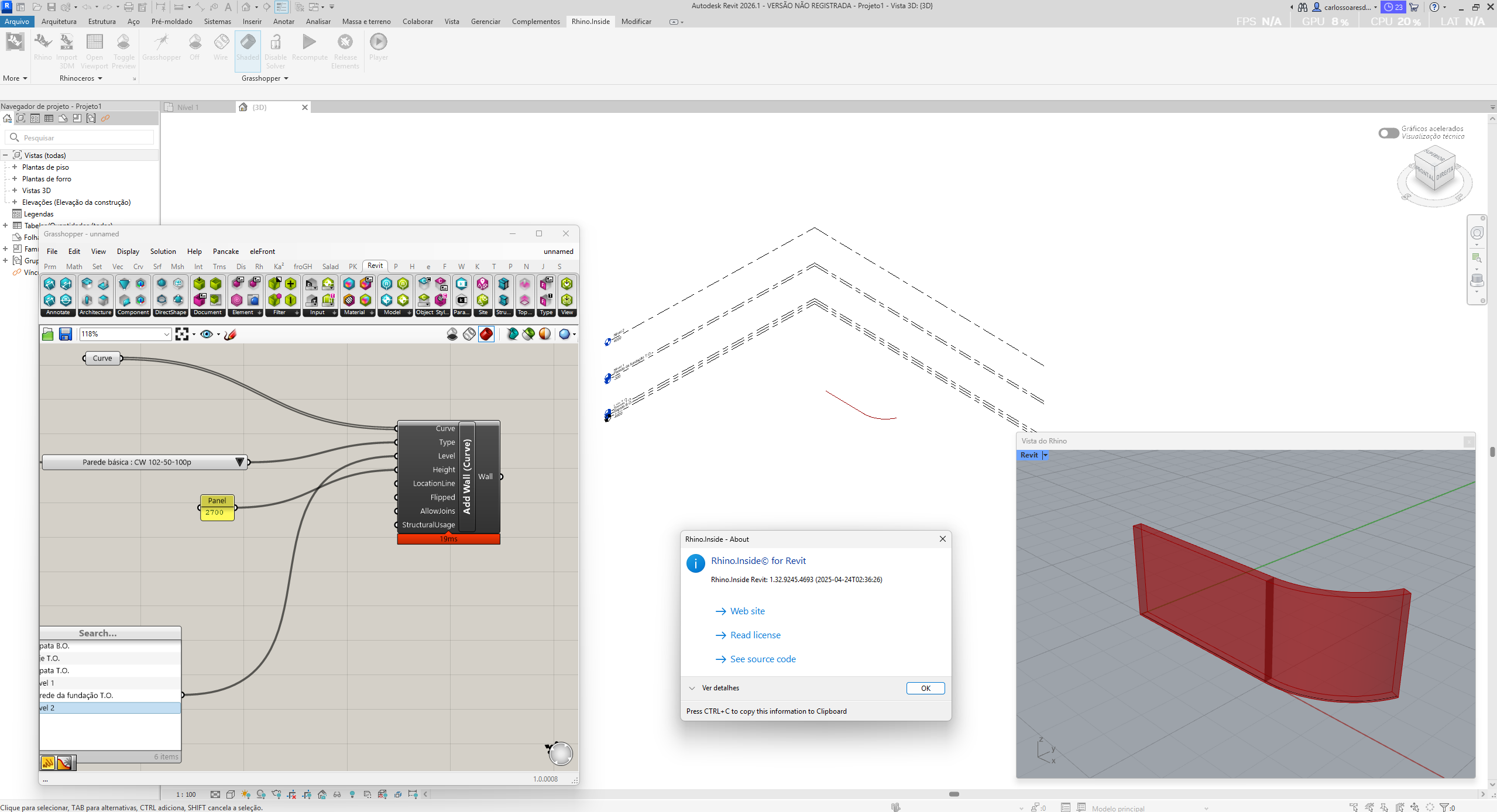

I’d like to know which version of RIR are you using now? you can check it via the About button under RIR cloumn.
Did you trun on the preview geometry in RIR ?

This is what I see… You can see the dialog with the version…

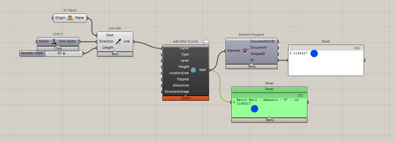

Just an extra comment… the Level is always the same… Never changes…

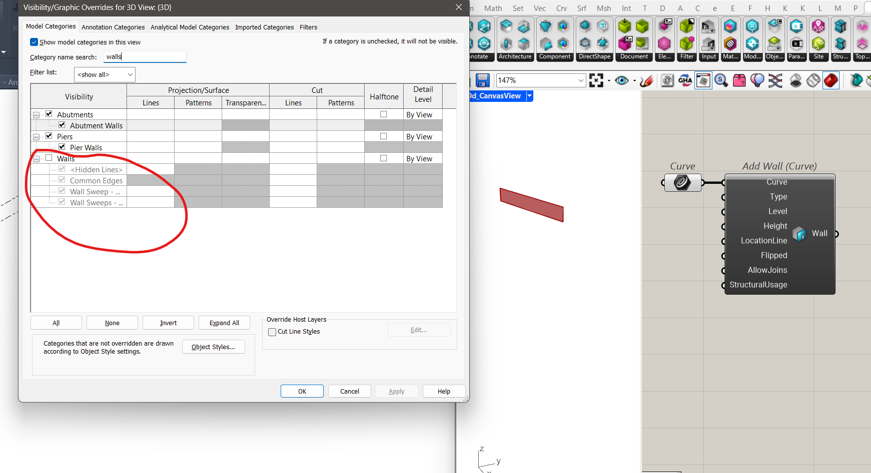

@CSousa Check your visibility Graphics in Revit.

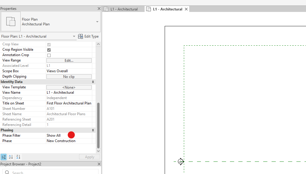

This is typically due to being on the wrong phase, also ensure you units are matching.
Can you select via the Element ID of the generated wall?

Thanks, but it’s not that… I have the walls turned on

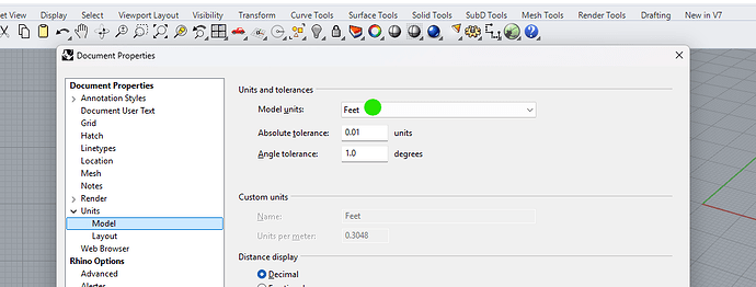

@Japhy I think that the units match… but since my knowledge of Revit is close to zero, I do not know what a Phase is…

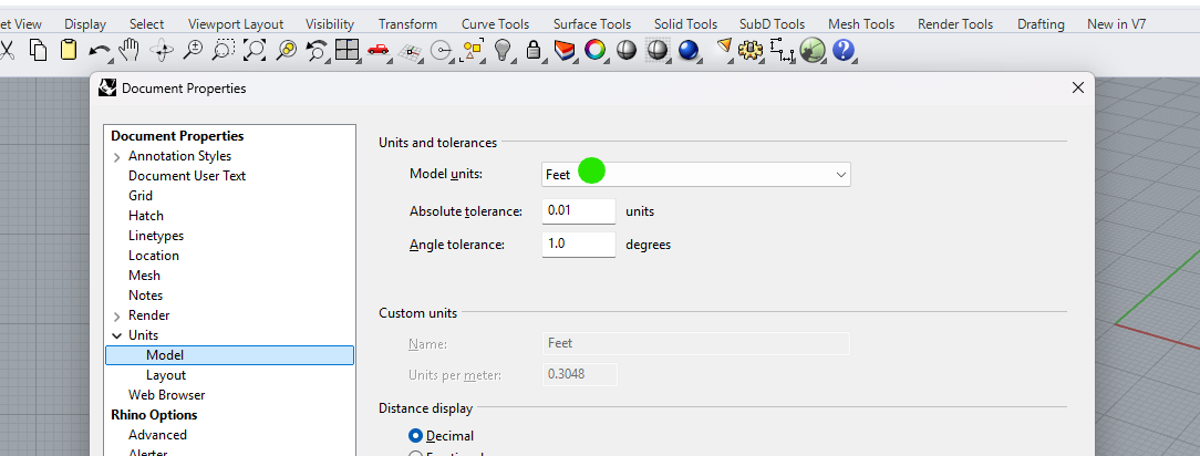

10
In Rhino you can run the Units command and see the model units.
In Revit
Select by Id is also on the Manage tab.
Phasing is one of the many ways to control visibility in Revit.

Very basic stuff… I can see both objects in Rhino but only lines in Revit
TestGH.gh (6.8 KB)
TestGH.rvt (3.9 MB)

Hi @CSousa ,
@Japhy has pointed out rightly. The issue was with the Construction phase. You can use the Element Phasing component to set the new phase.

You can also change it in your View Template

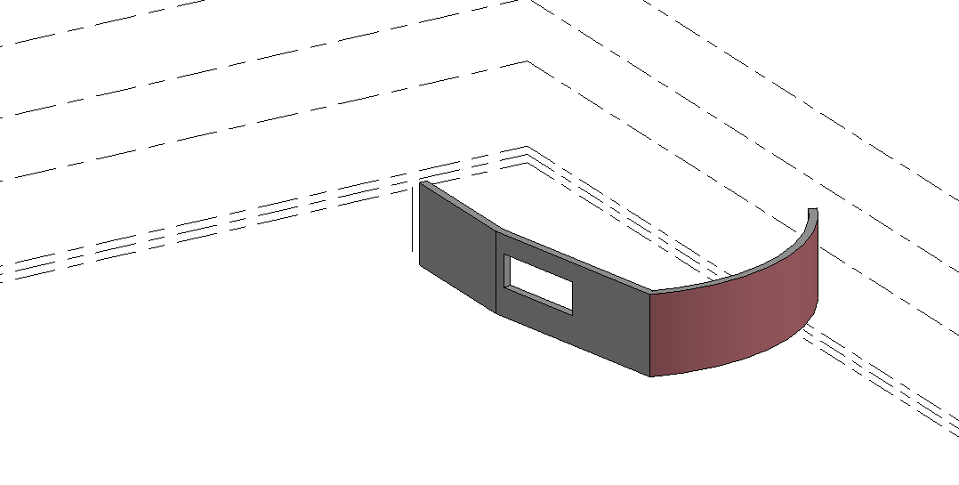

I see that I will need to learn a lot about Revit if I want to learn Rhino.Inside Revit…
BTW, my file had another object. Why do I only see the line and not the beam?
