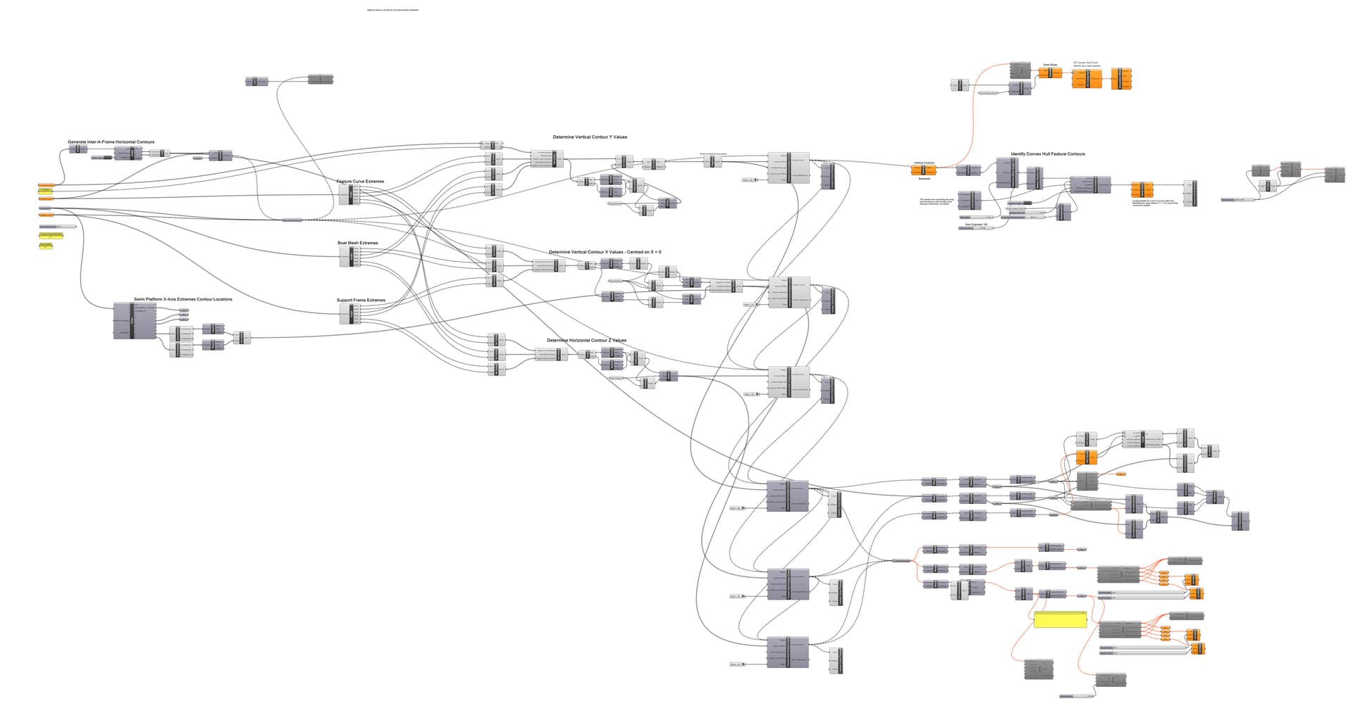

Grasshopper
This is what my Grasshopper document currently looks like:
Grasshopper file with inputs internalized: Convex Hull Slices - v2 - Internalized.gh (saved to OneDrive; too big for forum upload) Note: It takes about 43 minutes to run on my computer (11th Gen Core i7-1185G7 with RTX A500 GPU).
I’m Stuck

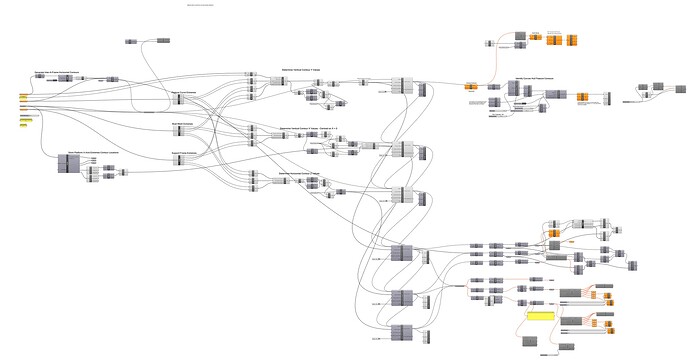

I’ve uploaded a revised version of my Grasshopper document with the convex hull contour curve data internalized so that others can avoid the 43 minutes of data generation. This version runs in 60 seconds: Convex Hull Slices - v2 - Internalized Convex Hulls.gh
I’ve also added some labels and a few more custom preview components to make it easier to visualize or turn things on and off.
The Grasshopper document now looks like this:
…and will generate this for you, minus the boat mesh and support frame (although those were internalized, too, in this and the previous Grasshopper files):
I note that I do have a convex hull curve intersection script that detects only intersections that exceed a set number of degrees deviation (“change in direction” of the curves)… it’s the middle right-most script and custom preview.
Any thoughts or ideas on where to go next to panelize the surfaces defined by the convex hull curves / intersections would be appreciated.
