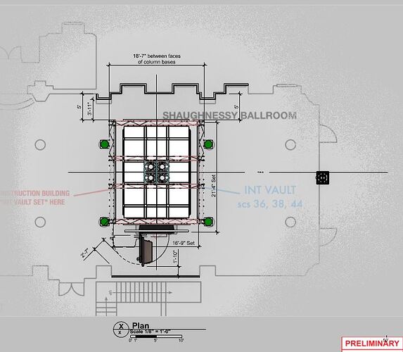

I’m confused about how this view changes. Attached is a recent effect I’m seeing in a rendered View MOde detail window, where it appears that light from somewhere is covering a (non-existent) plane with glow. Not sure why this is, with lighting set to Ambient Occlusion. Not a problem if there’s no overlap of details If I have detail windows layered on a layout sheet, this glow on nothing will fade anything on which it overlays.
