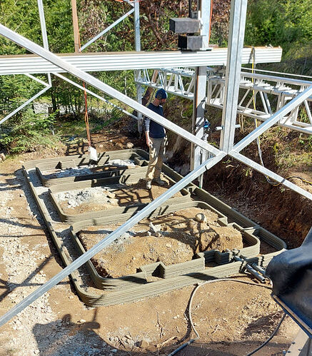

We are a very small company that just finished to build a concrete printer, we want to help solving housing crisis in Canada.
Veterans and natives are in need of places to stay, i mean good places, and of course no much money to do it… so here we are !
We printed a structure 10ftx20ft 8ft high, and we are planing to use geopolymer for the next project. From that we expect to get the attention of bigger companies that care of this housing crisis…

That is very interesting, I’d love to see some pictures of that. And some pictures of your printing mechanism if you have any.
