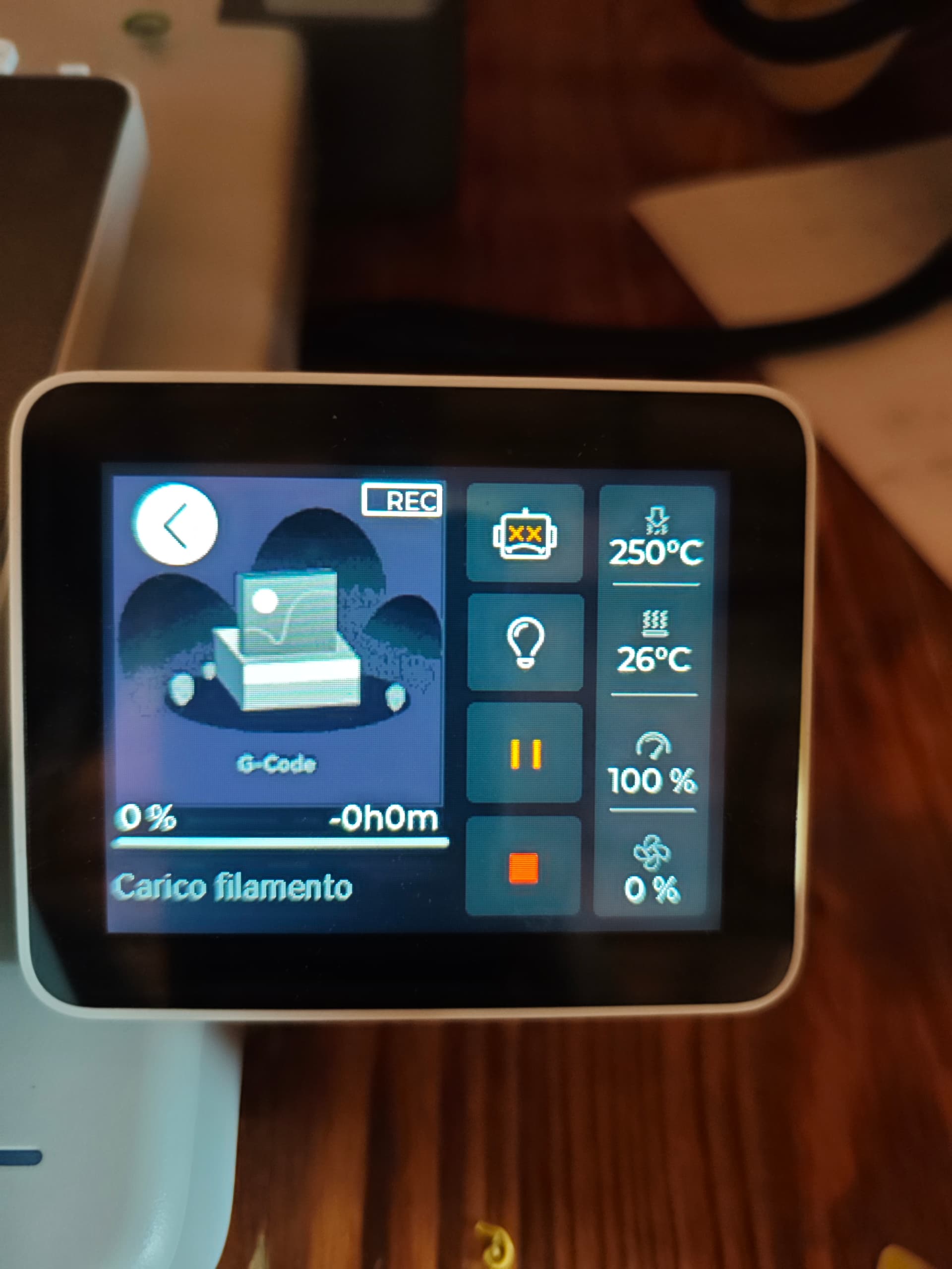

Hi everyone
I would also like to print a custom gcode made with Grasshopper with my Bambulab A1
trying3dprintbambuA1.gh (64.8 KB)
this is the script that i have used to create the gcode with the start and end part from bambulab.
this doesnt work, my printer start going hotter and hotter and extrude a lot of filament to clean.
i have check it with https://ncviewer.com/ and it seems to work
Is there any mistake?
Any help is welcome
don’t know about your start/end custom code, but what I can tell you from the Gcode you have generated is that between n points are generate n-1 segments:
in this case it means that wherever the printing head is located in the 3D space at the end of your custom code, it will want to reach the “print start point” location already extruding filament, which doesn’t sound right :slight_smile:
I think you should add an initial “0” (zero) to the list of Es, in such a way the print-start-point is reached while not extruding:
trying3dprintbambuA1_inno.gh (48.6 KB)
thanks man
I tried printing again but noticed another problem: the print bed remains cold and the extruder reaches a higher temperature than a normal print. Concerned by the excessive waste material (even for a Bambulab), I stopped the print and am continuing my search for errors in the script or in my understanding of how the Bambulab works. Thanks again for your help. I hope someone finds this post useful. I’ll keep you updated if I can continue.
I think that depends entirely on the instructions contained in the “Print Start” text panel
what I would do is to take a Gcode program generated by a slicer (don’t know if Bambulab has a propretary slicer) that works very well in your machine, and check what command it contains before actually starting to 3D print your item
maybe you have already done that, it just seems a very long set of commands (I’m used to 3D printing clay using Wasp machines, which is like 10 lines or code in total…)
Hi, were you able to print gcodes created with GH with Bambulab? The Bambulab firmware only accepts gcodes calculated with relative extrusion values ​​(command M83 = use relative distances for extrusion), meaning the extruded material count (E motor revolutions) starts from zero at each layer. Therefore, in GH, we need to insert M83 into the start gcode and calculate the extruded material values ​​for each layer, resetting them every time a new layer starts. I’m doing some tests and will update you.
in my experience the E is to be given for each single movement, not from the start of the layer
this is pretty easy with GH because it’s a value which is directly proportional to the length of the curve it’s going to move along
Hi, it depends on how you want the gcode syntax. If we use M82 (absolute values), for the E values ​​you will have to add a mass addition component, many gcodes are made like this (Marlin accepts both M83 and M82). If instead we want to print with BAmbulab we must necessarily use the relative M83 values ​​and declare it. There are other things that concern the syntax for bambulab. My tests now work with bambulab X1c. I have to try to make the flow function of the layer thickness for non-planar prints as the topic of the post.
