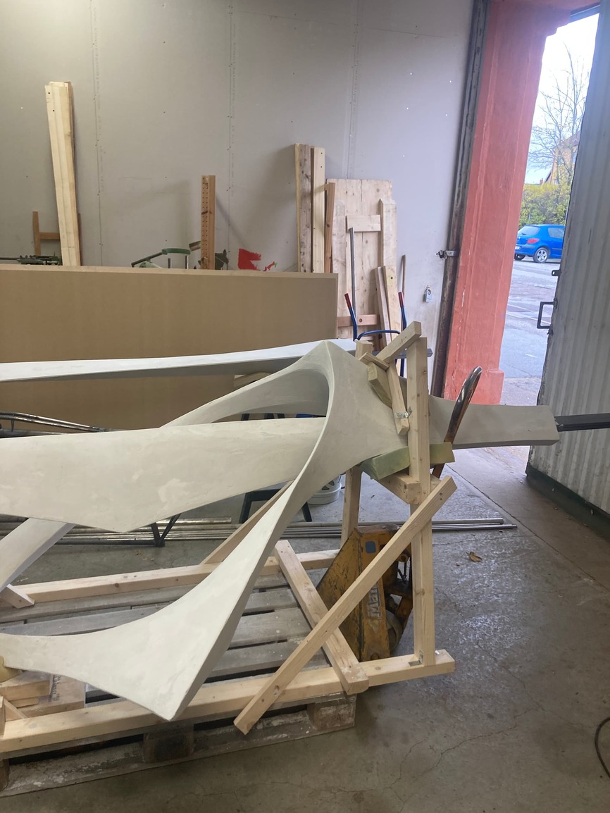

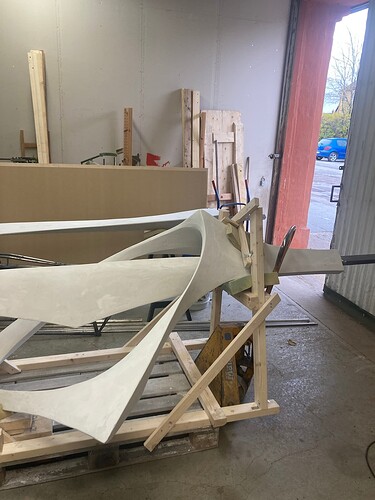

This is a chaotic project but at least there is finally some clarifications from the artist and the building company. The sculpture will finally be made from steelplates and the pipes will be not as many as in the 3d construction but grouped in the different thickness and bend to shape
There is a 1:1 gips model that will help with the construction. Bobbys help was worth off guld. Now is just lasercut the plates that stabilising the form. Pipes will be welding and bend to the approximate angle. The holes will be near the edge off the plates as they will be used to support.
