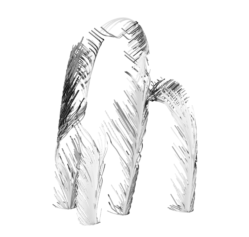

Wanted to ask if someone can point me in the right direction to create something like the steampunk pavilion designed by SoomeenHahm Design:
https://soomeenhahm.com/portfolio-item/steampunk-pavilion/SD
I tried using pufferfish closest vector loop space filling script and got the following:
As you can see in my attempt, the issue im having is the lines are not following the brep fully and its uncontrolled, creating many gaps and areas where lines just dont wrap around the assigned brep. As for steampunk Pavilion, lines follow the geometry and wraps around it fully in a controlled manner.
Ive attached my definition Pf_ClosestVectorLoopsSpaceFilling - Requires Anemone Plugin.gh (131.4 KB)
If you happen to know another strategy or an improvement to the script, would greatly appreciate your advice on this matter! :D!
Do you want to make something that looks like it or something that is buildable like it? If you mean buildable, then it is going to take a lot as those guys put a lot of effort into making that thing real (which is the really amazing part). If you mean just looks then look at plugins that perform swarms such as Culebra, Boids Library, Quelea, etc. (all found on food for rhino). That Pufferfish example I included in Pufferfish is not how you would make this geometry as the Steam Punk is not space filling and it is not a discrete movement which is what closest vector is for and is the point of my definition.

All of the schematic design was done without any surface modelling at all, using really simple techniques that as Michael mentions we’ve all seen a million times before. We were really just interpolating curves through vector fields (using Nursery https://www.food4rhino.com/app/nursery though I haven’t maintained this for ages). The nice thing about this design approach is you can generate really complex topologies really quickly. No underlying mesh, or even agenty boidy stuff needed.
After we were thrown under the bus and actually had to build the thing we built a surface model of the design and then used this as as a quick way of generating strips that didn’t intersect one another.
The complex (and interesting) parts of the design process all come from trying to simulate how the timber board will twist as you try to bend it into a particular curve, as this gives you both the design language of the pavilion (when strips overlap you read surface, when they don’t you read lines) and also the geometry needed to generate steel brackets that connect the strips together. We ended up using kangaroo to simulate both of these things. It was fun trying to build in all of the constraints for the steel brackets in particular - they needed to unroll to a straight bar so we could use standard flat bar to make them, needed to have minimal connections to surfaces, needed to have max bend angles so we could bend them by hand, couldn’t intersect anything (obviously) and needed to form geometry that would sit behind the strips where possible.
