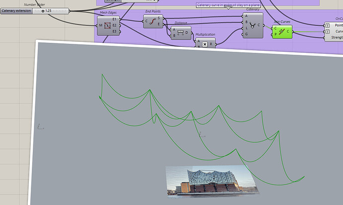

But this looks like catenary curve and some draping so Kangaroo seems also more appropriate

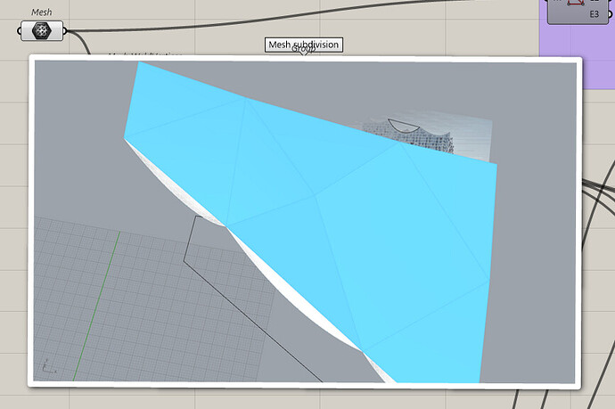

so the idea is the same has above, make a mesh.
Do some catenary curves between the points, they will be used to guide the draping. Without constraint on borders the draping will become convave view from above.
Make a mesh
Subdivide it for Kangaroo simulation
Make catenary curves on the edges of the faces, and use the same ratio for catenery . From the pictures the ratio seems to be like around 1.25 +/-0.05

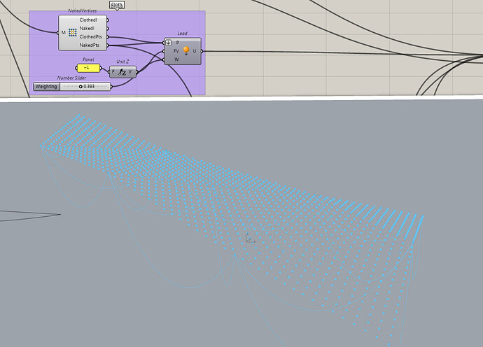

Anchor the points of the low res mesh
Add load to the points
Make Catenary curve inside Kangaroo (same ratio as the others)
Gives tension to the shape
Apply the magic

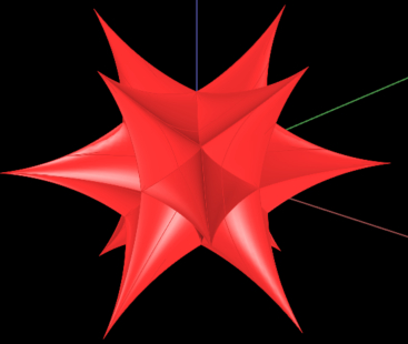

Does this shape have a name? I’m making a 3D print of it, but don’t know what to name it.
The base curves are generated by this component in the Viper 7 Plugin.
Maybe this is the correct name.
Get latest version from GitHub, not F4R.
GitHub - zohozer/Vipers: Vipers: Components developed by Tang Chi for Rhinoceros/Grasshopper.
Thanks Quan - I was not aware of that plugin. What’s interesting about it is the way it enumerates the edges. I tried substituting the stock GH dodecahedron and icosahedron objects, but they failed miserably, apparently becausse of the way the surfaces and edges are generated.
I’ll update this post with a pic of my 3D print in a few hours. It’s actually quite nice.
OK - I got the Viper 7 GHA plugin working OK. There sure are a lot of objects there. But none of them match the one you showed. Viper 7 has 6 different polyhedra objects named PolygonA, B, C, D, E, and F. The one that works best is A:
1
But this is different from your original post and I haven’t been able to find anything in Viper 7 that matches that shape:
Have you tried to right click on the component? That component gives three options.
