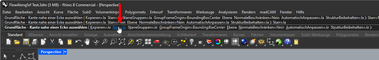

I don’t see the new option.
Aha, it becomes visible when using the Rigid option:
