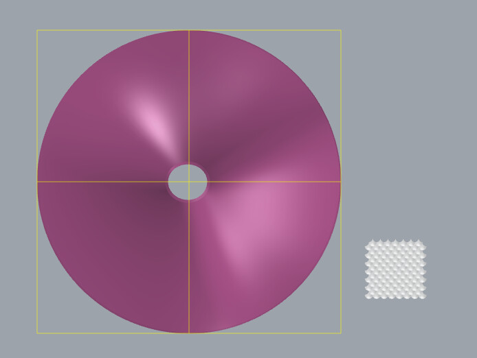

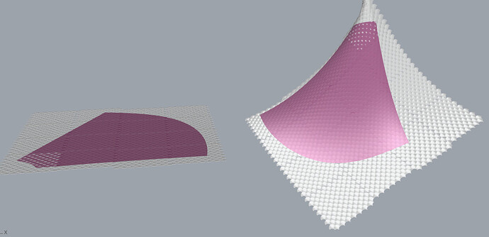

Im trying to map a roof shingle pattern on to an organic roof surface. Im having diffulties mapping using flow along surface command since its leading to distorted tile geometry. Ive included the rhino files!
… always nice to have a screenshot… (from your rh7 file)
you will get some problems if you planed to have same amount (number) of shingles in the first row and very close to the center.
what s the Idea, how do you want to handle the different circumferences ?

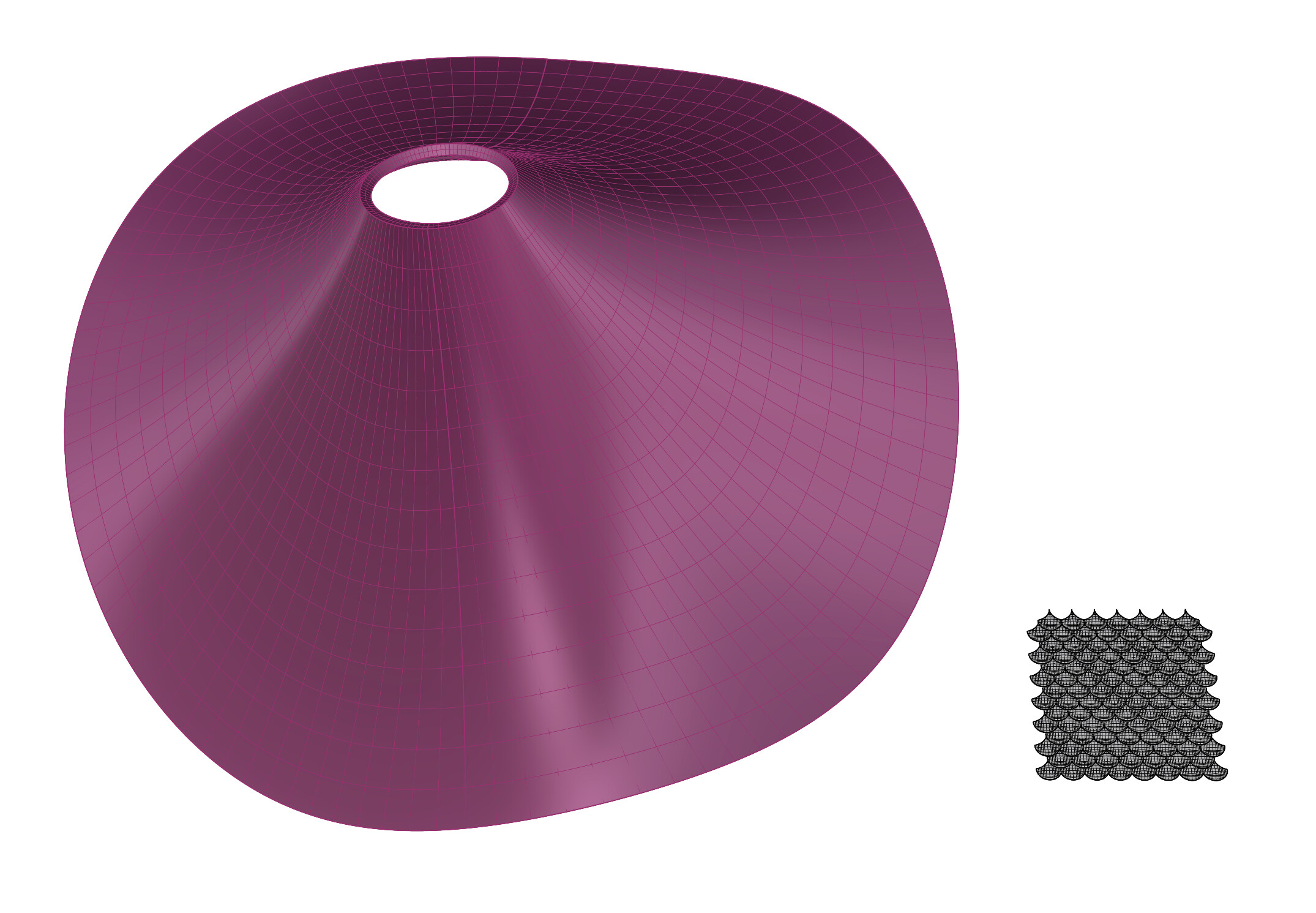

The goal would be to have shingles all roughly the same size with the goal of achieving a similar pattern typology as shown on the right of the screenshot. Doesnt have to be perfect, its just for a render.
I understand that when using “flow along surface” the panels that approach the top of the conicol shape become compressed. Just trying to figure out how to avoid that. Maybe a different command/approach is required?
