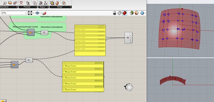

I’m pretty new with grasshopper and I have an issue:
I have a portion of a spherical surface with multiple curves (obtained by brep- plane intersection), and I want to find and select all the intersection points of the grid. With the first brep-plane intersection i get the horizontal curves, with the second the vertical ones (image 2); I tried with the multiple curves intersection but it does not work and i got just the points you see in image 1.
I think this is because the output of the brep-plane intersection is not a set of curves but sort of a mixture between points and curves ( see image 1) and I don’t manage to split them (i tried with cull pattern but it s not working).
I have the possibility to increase the number of curves in the 2 directions with a slider and I want all the intersection points (underlined in blue) to be found in order to then define a pattern.
Any suggestions?
thanks a lot for helping

Are you trying to get the point data to be organised like a grid of cells, point rows as branches, or you just need those points but their order does not matter?
Also, always attach your file even if it is wrong or bad - saves us time recreating things.
Hi, the quick fix is to flatten the input to the multiple curve intersections node…
I want them to be organized, better if in rows, because with this points i than have to define an hexagonal pattern on the surface like in picture, using certain points as nodes. Sorry but I cannot share the original file as long as it is an entire project…i know it would help a lotpattern
This is a way you could do it. Using Pufferfish’s Parameter Grid On Surface component (green in screenshot) you can get the grid cells and grid points from your planes by intersecting the planes with a U and V surface edge and using the reparameterized t values of the intersections. Then do whatever you want with the grid (like connecting dif ways for hexagon)

You were right, was just a matter of flattening the inputs, thx a lot!
I tried with Pf but in the end was much quicker to just flatten the input in multiple curves intersection! It worked…
Thanks anyway a lot for the quick answer!
PF solution would be much better to have the points organized, but with the structure you gave me I have issues with the surface…probably because it comes from a brep deconstruction! Thanks anyway!
You’re welcome, but it is as @Michael_Pryor asks you, you will not get the points in a structured way, like in branches. You’ll loose the “structure” of the data when you flatten.
How about you take a two step approach?
  1. Intersect Brep with “Row” planes…
    … graft
  2. Intersect each result cuve with “Column” planes
    … sort by curve parameter if you like
have a tree of points in row/colum order

Hi guys, sorry to be back again but I’m really stack in this problem since yesterday…once I defined the grid of points that now works correctly, i want to define a pattern to selects some points to create exagons like in picture ( the number or rows and colums can be adjusted by sliders and also we can “condense” the structure at the edge and in the mid-line, in order to change shape and number of hexagons). My idea was first to separate odd and even rows. Than on any of the 2 rows of points define a true false pattern (cull pattern/ dispatch). The problem is that when I apply a true false relation I don’t know why the pattern is not applied correctly and if i make a true/false happens that I get a true true/ false false relation.

First things first: the failure of the pattern is indeed due to the order of your cutting planes.
B-Planes are ordered from to bottom, so you don’t need to change that.
A-Planes are “random”. Since you get your A-Input to the Plane from evaluating a curve with length parameter, you can use just that to sort your A-Planes as well. Just sort the L-Input to the Eval Component and sync-sort A and C Point inputs to your A-Plane.
Your points should be correctly ordered now.
