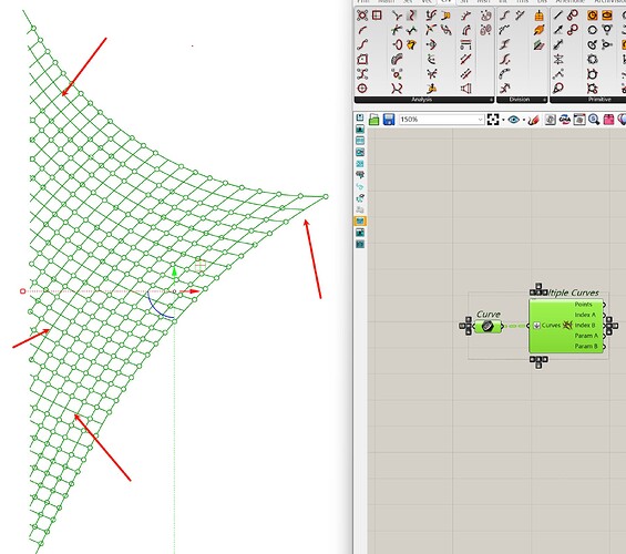

Hi friends,
Multiple Curves Intersection output wrong results? I can’t figure out the reason,so I need your help.Thanks for any hint.
CRV intersection.gh (12.2 KB)
Many curves do not intersect.
As @leopoldomonzani points out, your curves don’t fully intersect in some areas.
I did notice things were almost planar, so a quick cheat is to fit a plane and project, then intersect and go from there:
CRV intersection.gh (26.4 KB)
What happens next? Splitting curves?
The data structure seemed ‘odd’, 25 branches with only the first one containing 31 curves, while the rest are all single curves. Not sure how this came to be, and it’s none of my business haha, though it could help to order the contours based on their directions (like ~X curves vs ~Y curves).

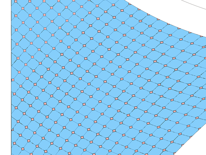

Next,I want to split the original surface with there curves and also add some change at these points.
Like this:
Seems like a very roundabout method unless I’m misunderstanding something. The GH you supplied is obviously removed from context. How is the original surface defined? If it’s a nice 4-sided surface, you could generate the pattern as a flat array then use Map to Surface to transform it.
Curve Mapping.gh (8.1 KB)
This is a simple array, but if you wanted to generate a trimmed surface fro each “tile” you could stucture the source curves in other ways.

Ok, here I extrapolated the surface based on that curve and used that surface to array the pattern. I made the pattern parametric also. Usually I would rationalise the “geometric position of XYZ components” to something smaller, but this way is more illustrative of what’s going on.
This is a much more robust approach because we guarantee a clean input (4 single-segment curves) and everything happens in Surface World.
Right now it just trims the pattern outlines, but you could generate surfaces from the polylines instead and trim those. All sorts of methods are possible.
pattern via surface.gh (36.1 KB)

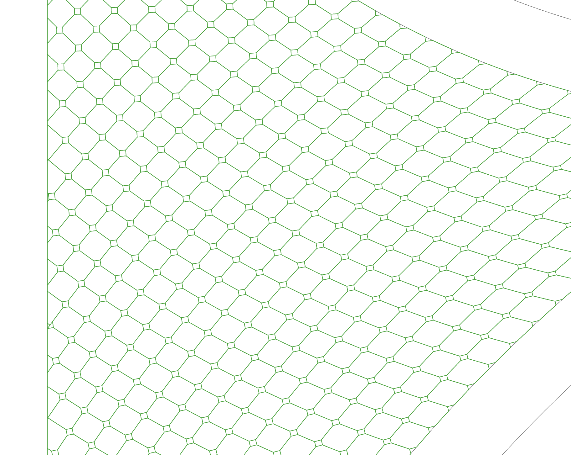

Nice idea.I tried this idea too and the result(blue curves as below) seems more even than Tom’s way.
However,by using the mapping way,it’s hard to control the final result exactly.So I prefer offset the boundary curves directly as we have discussed before.
Thanks for this info,I will try to learn clipper2 plugin in the coming days.
Very interesting seeing the difference in grid spacing. Of course the UV grid varies with boundary curvature. I’m sure there’s a way to “regularise” the UV spacing but if you want exact dimensions then offsets probably are the only way to go about it.
