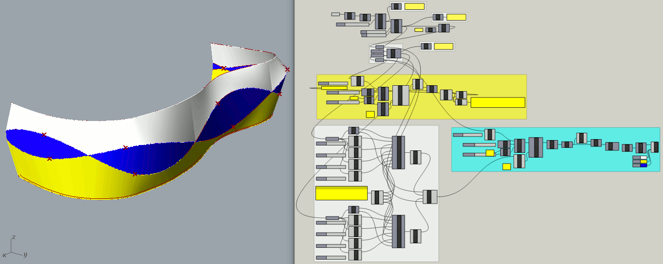

I’m stuck here and having trouble figuring out a strategy to develop a correct shape:
The shape of a facade is generated via two curves. As the curves are drawn manually in rhino, the script should be able to pull them together to make the physical intersection in the place where they are closest to each other and their “z” component is the same.
Basically, I believe I have the strategy set up the wrong way. Any suggestion on how to model this shape is welcome.
301.gh (23.4 KB)

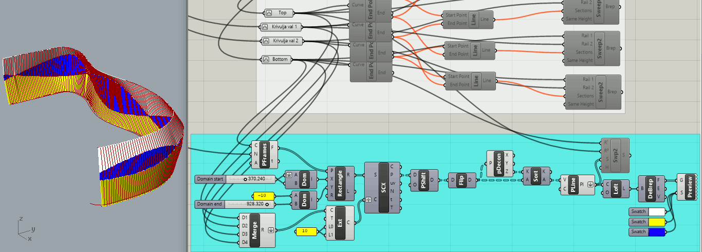

The only code I wrote is in the cyan group (below). It replaces your white group in trying to create the surface(s) between all four curves. It uses PFrames on your bottom curve (the shorter one) to create rectangular surfaces that will intersect all four curves. Using surfaces instead of planes is better because many of the planes will intersect the curves in two places instead of one. Four intersection points for each PFrame are sorted by their Z values and connected with a PLine (PolyLine), which are then lofted. It’s not perfect, especially where the two middle curves don’t actually intersect, but it’s not bad?
301_2019Jul29a.gh (34.1 KB)

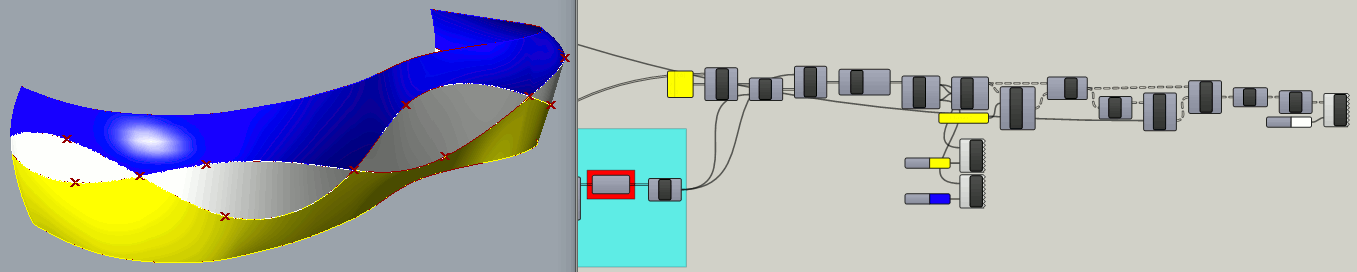

Here is a hand crafted version using your “intersecting” curves as guides to get:
  • four intersection points
  • four “peak/valley” points from each curve
  • the start/end points from each curve
It still show anomalous artifacts in the surface at the intersection points and I’m starting to wonder if the flaw is due to a faulty assumption about the geometry rather than a flaw in how the Loft sections (PolyLines) are created?
301_2019Jul29c.gh (37.5 KB)
Almost as if the surface touching the top curve and the surface touching the bottom curve should meet at a curve through the intersection points, and only then would the intersecting curves be “applied” to cut away the area between them?
Ugh! A quick hack to try that fails so badly I won’t bother to show it. This may be even more of an art project than it first appeared.

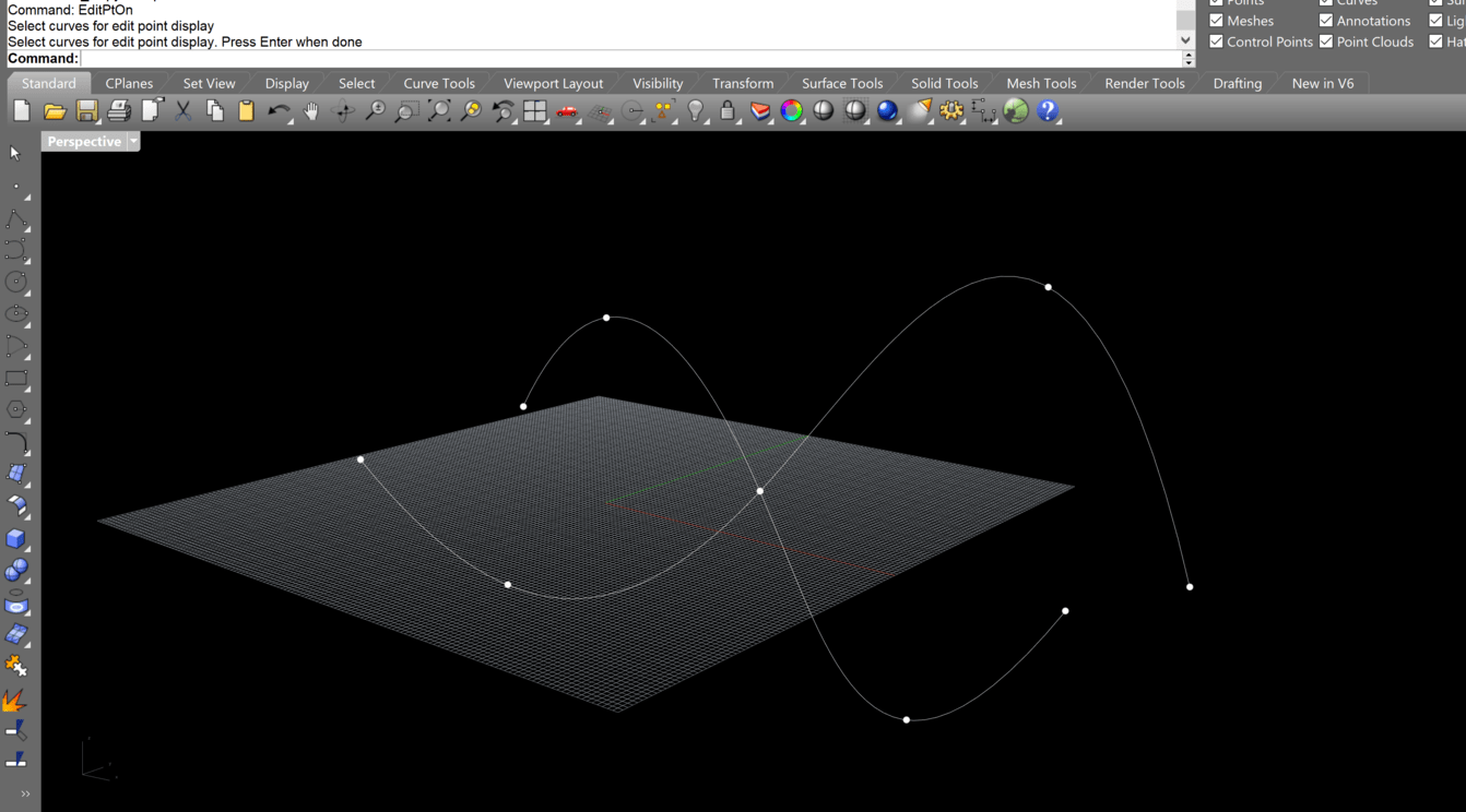

If you still want your curves to be created in Rhino and not built in grasshopper using points in rhino and interpolate curves. Have a look at controlling you curves in using EditPointsOn rather than Control points this way you can keep the intersections set and deform around them.

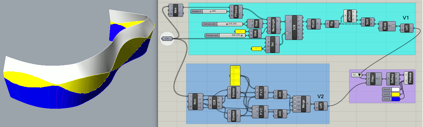

Setting aside for the moment how the two intersecting curves are created, let’s assume they do intersect and focus on what happens after that. This model does that. ‘V1’ (cyan group) is what I posted yesterday, ‘V2’ (blue group) tries a different method using the same curves.
The purple group switches between the two results:
301_2019Jul30a.gh (28.4 KB)
