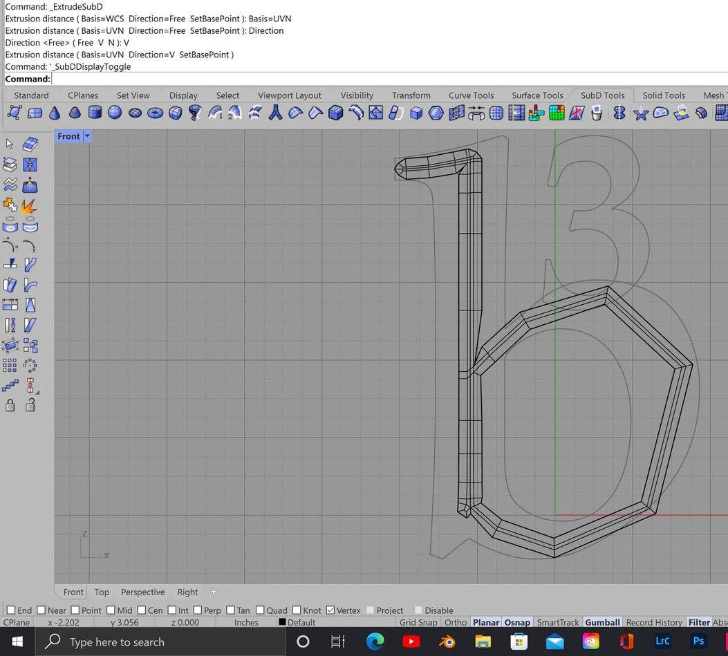

I reported this about a year ago and had hoped it might be fixed by now. It adds so much work to my workflow so am hoping some attention can be given.
I set the direction to ‘Free’ and then to ‘V’.
Then I set a number to extrude to (say 2)…some of the values are right but many times the values are ‘what-ever Rhino wants’ and it means having to go through and fix every one by hand. The example shown is a ‘good’ result. Many times it is very bad.
I know there will be crossed polys regardless…that I can deal with.
Please give this some attention. I use this tool all the time.

Here’s a file. Very simple to duplicate as it always happens on every project I’ve done.
Select all of the outside edges. Hit Extrude SubD. Change dialog to ‘Free’. Then change to ‘V’. In this case type in .15. Then do the inside edges if needed.

so the complaint is if you enter a unit value, the unit value is not consistent to the rest of the model? (which is what I am seeing here)
this was my result after I entered .15
If I type in 1" I want the ribbon to be 1" all the way around. It changes arbitrarily as it ‘extrudes’ different edges. Is that clear?
Also…why is it ‘rounding’ as it goes around corners?
got it- I’ll write this up.
