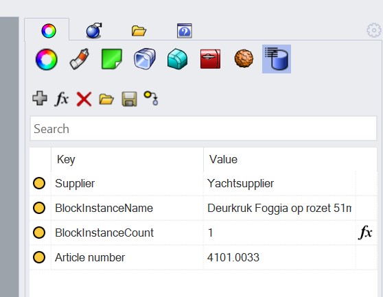

In the drawing I use “Object user data”, to attach data to blocks.
I would like to export this data to Excel.
I know how to export the “Object user data” per block.
How to export the data of multiple blocks at once?

I added Object user data

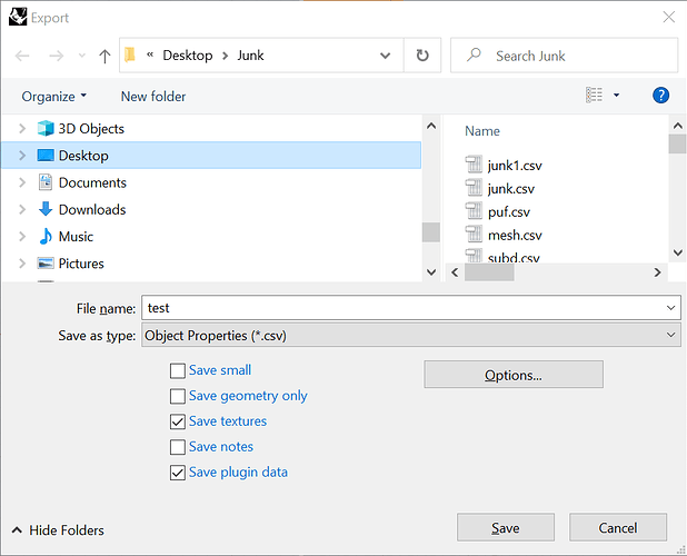

Hello - export to CSV should get this information.
Hello Pascal,
I want to export all the blocks in the drawing.
I select multiple blocks, but only one block is exported
Supplier,Yachtsupplier
BlockInstanceName,Insteekslot 104K WC Rechts 40/8 Messing Chroom drie-delige anti-rammel schoot
BlockInstanceCount,%<BlockInstanceCount(“2352fc3c-dec8-401a-9ef6-5115727908c2”)>%
Article number,1102.0055
Here, more than one block is exported to csv but the instance level user text is lost - I’ll look into this.
RH-65035 Export csv: instance user text is skipped

How did you access that pop-up window with checkboxes? I cannot find it anywhere. Thanks.
select the blocks, then export
@D.Ronald - did you find this? The dialog in my image is the export dialog when CSV is the chosen export format.
@Pascal, @ron9
I tried all of these things previously on both Windows Rhino 6 and Rhino 7 (both latest Service Releases). That popup dialogue never shows or is an option. That’s why I asked. It’s a great feature.
I even tried enabling the Options > Advanced settings of export document user data:
Hello- select any object, type Export and Enter. Choose CSV as the export format.
