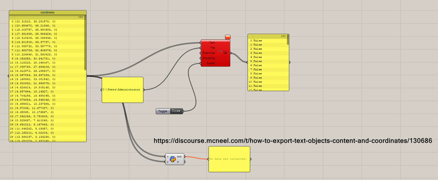

Exporting coordinates to text?
All I want to do is export multi-line coordinates to a text file …
What am I doing wrong?
Exporting coordinates.gh (12.8 KB)

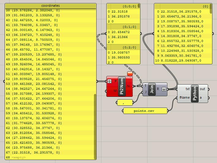

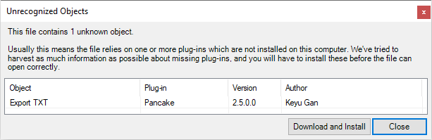

Hi MJD,
Does right clicking the text panel and Stream Contents (and Destination) work for you?
missing
Your text panel has an extra empty line that causes the red component and error message, but we can ignore that.

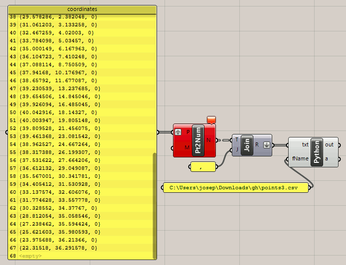

Exporting coordinates_2023_Aug8a.gh (18.3 KB)
text = ''
for t in txt:
    text += (str(t) + '\n')
a = text
f = open(fName, 'w')
f.write(text)
f.close()
P.S. Or more simply:
text = ''
for t in txt:
    text += t + '\n'
f.write(text)
f.close()
Exporting coordinates_2023_Aug8b.gh (14.2 KB)

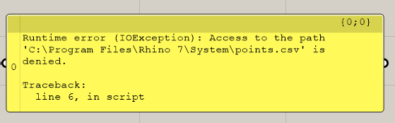

@Joseph_Oster I get this runtime error?
Try changing the filename to include a folder that is not in the ‘/Program Files’ directory? For example:
C:\Users\userName\Downloads\gh\points3.csv

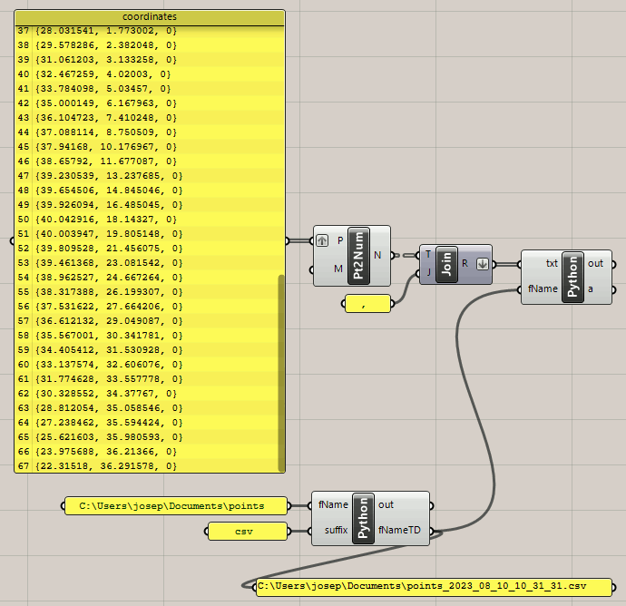

P.S. You could include date/time in the filename:
import datetime
now = datetime.datetime.now()
Y = now.year
M = now.month
D = now.day
h = now.hour
m = now.minute
s = now.second

Exporting coordinates_2023_Aug10a.gh (16.6 KB)
import datetime
def padLeft(num, len = 2):
    return str(num).zfill(2)
fNameTD = fName + '_' + padLeft(now.year) + '_' + padLeft(now.month) + '_' + padLeft(now.day) + '_' + padLeft(now.hour) + '_' + padLeft(now.minute) + '_' + padLeft(now.second) + '.' + suffix
