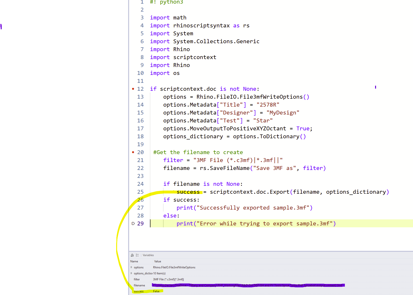

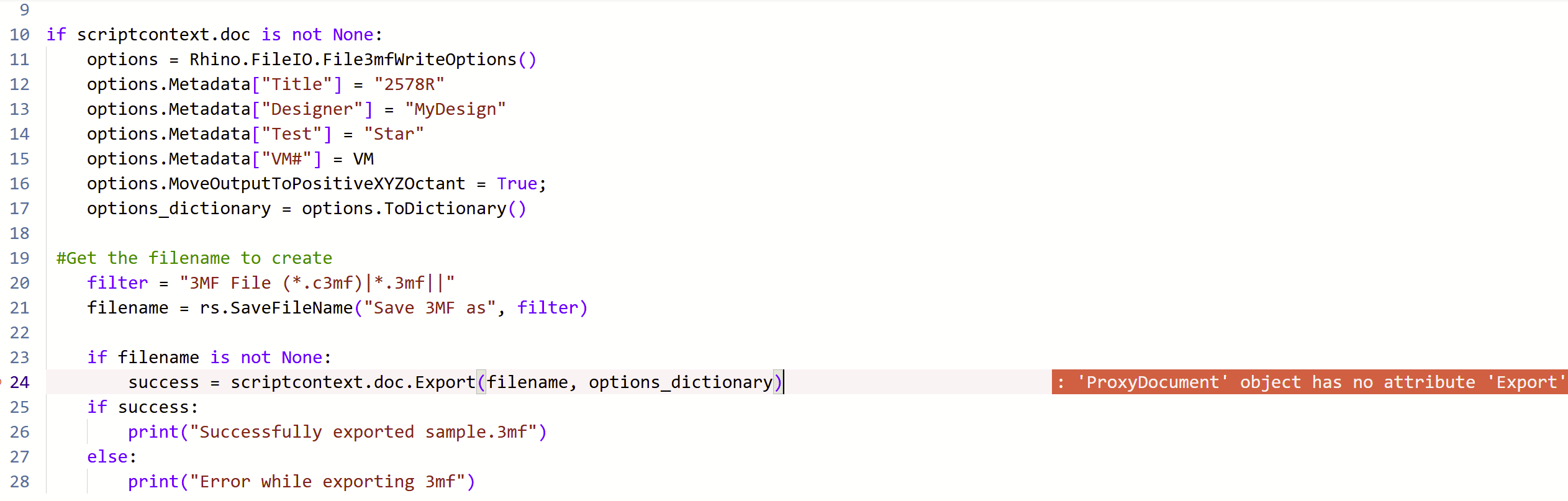

@scottd is this meant to be run in GH Python editor or regular Rhino Script Editor? When I try in GH I get an error on line 24:
And similarly in RH 8 SR17

The example above runs in Script Editor, Python 3, Rhino 8 for Windows.
Here is the detail on running the File IO in different contexts including a Grasshopper template: Rhino - Code-Driven File IO
