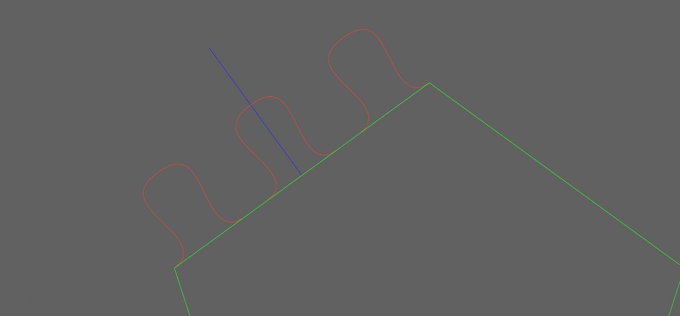

I am trying to duplicate and evenly space the small “tab” curve along the edge of the pentagon. I would like to have three evenly space tabs along one edge of the shape, equidistant from both the vertices and each other. I have tried to orient the object along the curve then arraycrv but the “tab” object is not evenly spaced in the way I described above.
Can someone help me figure it out? A picture is below and I can attach more for clarification if needed.

Hi Adam- see the attached file- I used the ‘Distribute’ script here:
http://wiki.mcneel.com/people/pascalgolay
To evenly space three items, place five - the two end ones are there only to set the limits and can be deleted. The ones between need only lie on the line, the script will space them evenly- use Direction > User and set the direction snapping along the side of the shape and then set spacing style to ‘Gaps’

here’s the g_fabulous method if you don’t want to do maths and don’t have a distribute plugin available :wink:
(hopefully not as confusing as this drawing makes it out to be)
You could use the Move command to position the tab along the curve. Then mirror it about a perpendicular curve (in blue) snapped to the mid point. You would then copy one of the tabs and with smart track on move snap it to the perpendicular curve.

Basic math stuff then draw line along the curve to spacing distance (4.5). Then mirror along a perp curve snapped to the mid point. Then copy and move as before. Jeff I like your latest method best super fast and simple, congrats.
Thank you everyone for the help, I will try the suggested methods out and ask again if I have any more questions.
