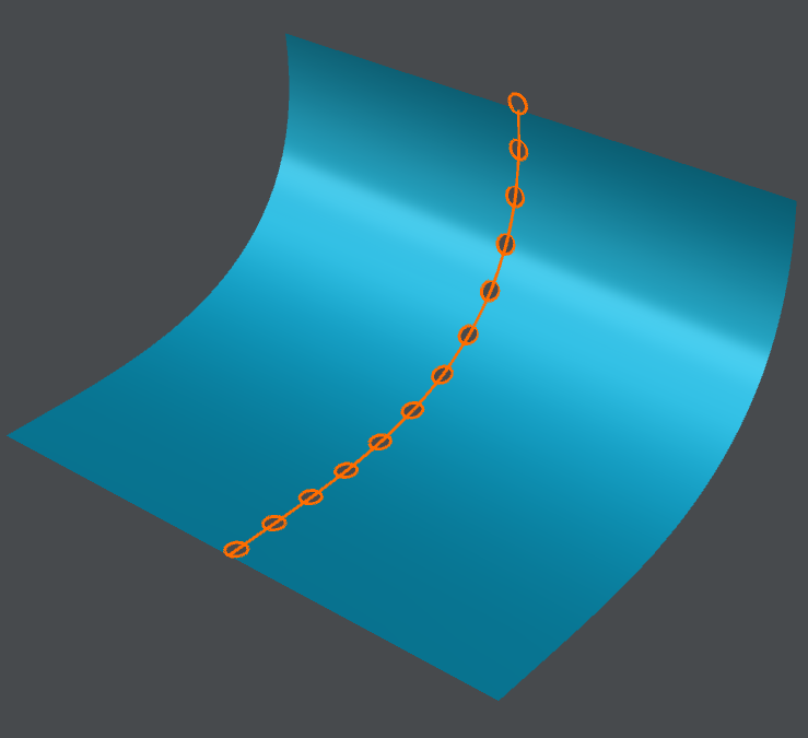

I need to place circles (acting as visual rivets when seen orthographic plan 2D) of equal spacing, lets say 20mm, along a curve on a curving surface (aircraft skin),( curve being line projected to surface), but I dont know how many will fit that line.
What is best method to select the circle, indicate spacing between centres, and have it fill curve with circles, these circles being on the surface ?

Hi Steve, try ArrayCrvOnSrf Start with the circle on the origin.
or place your circle at the start point of your surface curve and simply use ArrayCrv.
choose your distance, select freeform and done.
You’d probably do well to have a play around with ArrayCrvPlus: http://www.dig.gallery/misc
It’s really helpful for this sort of stuff. It does what Rhino already does but it’s helpful insofar as you can make amendments on the fly and test out settings without committing, undoing and then reapplying.
Andy

Hi, using RichardZ method, I drew circle, oriented it flat to surface, upon choosing freeform I get a short overlapping array not following curve. Tried again road option this time, and they follow around the fuselage, but upon close inspection they are standing off at their lower edge .
How do I use ArrayCrv and get them to lay fully on the surface ?
Now to try Pascals.
placed circle centre at start of line on surface, selected surface and distance 25mm, a new circle appeared moving with my mouse, hit enter and it was placed on surface :slight_smile: but that was it, I gained 1 rivet. How do I get them autoplaced 25mm apart ?
Try Miltiple and bingo, however the first two are not 25mm apart, rest are, and the last stage of the command place object, when I have alreadt placed where I want the first rivet, doesnt make sense.

Hi Steve,
Looks like the ArrayCrvPLUS plugin had a bug that did not let you work with a base surface if it was not an extrusion object (the script is quite old and no longer being developed).
It is fixed now. I updated the download link or just use the version attached here. Simply pick the surface your path curve lies on to have your circles oriented to it.
(make sure you uninstall the previous version first…)
ArrayCrvPLUS.rhp (318 KB)
EDIT: Circles oriented on curved surface will not lay fully on it unless you pull them to it afterwards, but then they will no longer be perfect circles…
hth,

The website link that Andy pointed you to for ArrayCrvPlus has thorough documentation and videos on the workflow. Please read that first.
ā€œFrom Pointsā€ option lest you select predefined points on curve. This way you can divide it using Rhino command and then use points for circle centers. This is optional, depending on your needs.
It does not matter where you place your 'Item" circle. WorldXY plane will be used as a reference to its orientation for XYZ to surface/curve UVW coordinates. The Items will always start at the path starts. You have a choice to either make your path curve shorter and start where you want your first circle center to be, or in ArrayCrvPlus Path menu use AdjustEnds option to define where to start. Again, it is all documented there.
Please note that the distance is measured in curve arc length, and not actual spacing between items, so in areas with more curvature the item-to-item discance will vary slightly. If you want equidistant array spacing, Armadillo has this option; its not a free plugin however.
hth,
–jarek
