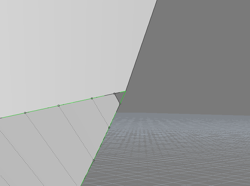

It’s the problem I expected: Rhino has difficulties unrolling the lofted surface which ends in a single point:
A workaround for this is to delete the first pair of control points:
Thanks for the help. It would have taken me a while to stumble into that solution.
chuck
It’s on our list to improve this, we are thinking to make the workaround part of the plug-in (as an option).
