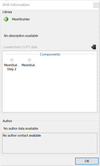

Is your gha loaded though memory or directly from the disk?
Hi Dave. Happy new year!
I believe it is loaded from disk.
I compile my .GHA in Visual Studio and save it in the …\AppData\Roaming\Grasshopper\Libraries folder.
Then it is loaded when Grasshopper loads, I suppose.
Grasshopper can load plugins in two ways, and the sequence of decisions that lead to either of these is very complicated, although the default is to load from disk. You can tell by looking at the plugin details once Grasshopper has started. Open up the About dialog, click on the little plus icon in the top left corner, double-click on your plugin icon and look at the loading details.
Other question, is the pdf dll file unblocked in Windows?
It says: “Loaded from COFF data”
Yes, the itextsharp.dll is unblocked in Windows.
By the way, I copied the itextsharp.dll to the …\AppData\Roaming\Grasshopper\Libraries folder
Now it works.
Is this the recommended solution?
No. Ideally you wouldn’t use COFF loading. You probably have the checkbox in the _GrasshopperDeveloperSettings command enabled. That shouldn’t be the case.
You can add an assembly attribute to your plugin informing Grasshopper how you want to load your plugin (I can’t give you an example now, on an iPad).
Or you can handle the framework assembly resolver event and load your pdf dll through code.
