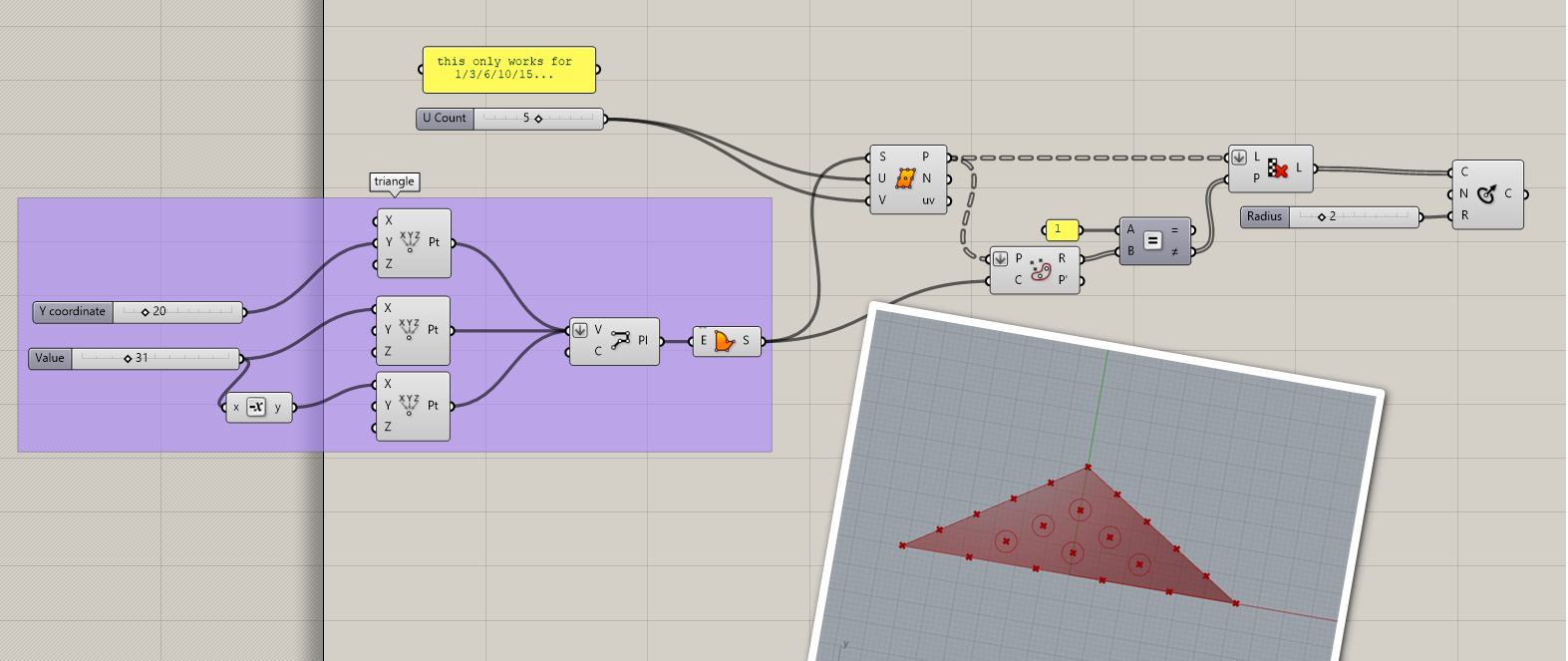

I want to equally space N circles regularly within a closed triangle. Is there a command or plug-in that will do that? I have RhinoCAM 2018 and I tried using “NEST” but that wants to crowd all the circles into one area of the triangle, which makes sense as that leaves the most unused space in the material for a future project. Adjusting the circle to circle spacing as well as the circle to boundary spacing in NEST didn’t give me what I was looking for.
I can set the circles to the points of an equilateral triangle and then do linear arrays in the three different directions and get an equally spaced offset/not rectangular array, but if the triangle I’m trying to fill is not equilateral then there is empty space or circles overlapping the triangle along two of the sides (100, 40, 40 degrees, not 60,60,60).

hi Michael. maybe this helps? it’s using the divide surface component to create equally spaced points inside the triangle and cull pattern to filter out those points that are on the edges (all points that don’t have a point in curve relationship of 1).
circles_triangle.gh (14.1 KB)
Thank you for taking the time to make the GH script, I’ll see what I can do with that.
