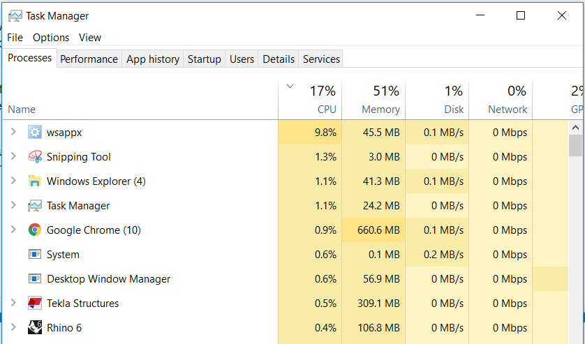

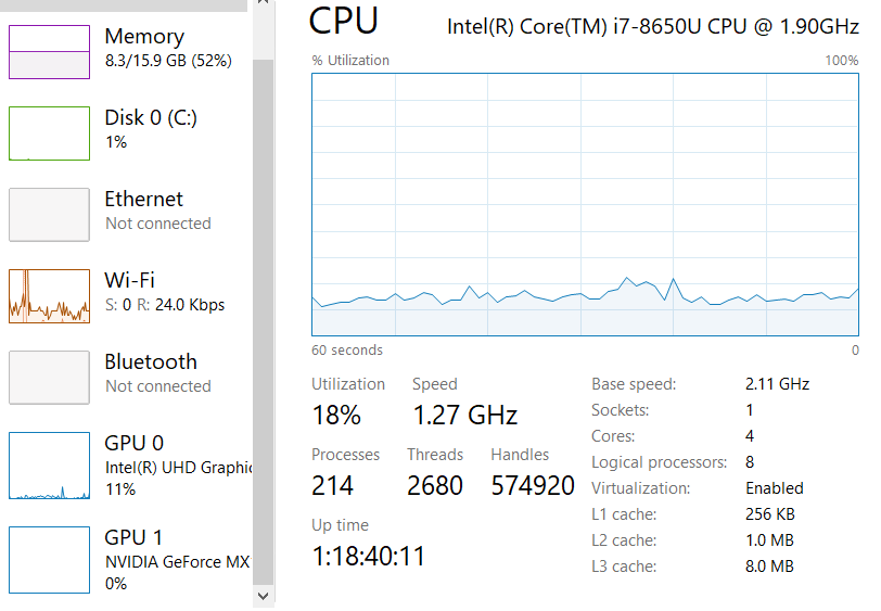

You can see in the picture below, that there aren’t any resource intensive tasks. Computer isn’t under load.
But feeling is like, the computer is trying to render a movie, everything else is lagging a little.
Close only Rhino, and everything becomes smooth.
