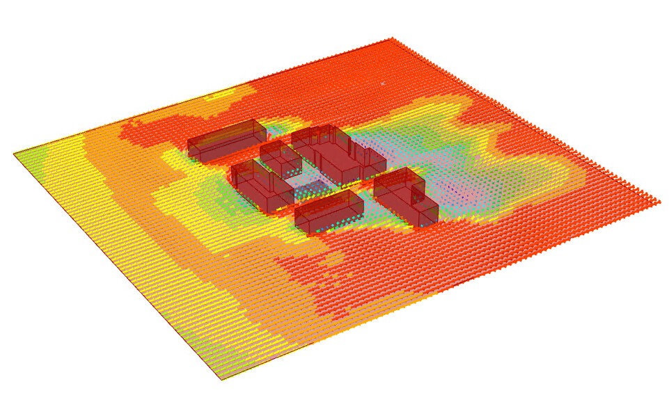

Hi Eddy3d team! I tried to run the exact same file you sent to @tgibbons, just toggling buttons and not changing a single parameter, and my results were like this, why could this be happening? The same is happening to other simulations I’m trying to perform, my results are all weird. Could you guys help me with this?
How did you convert these arrows into vector graphic representation?
was just looking for this as well, so just connecting the solution here: Smoothed Contour Mesh from Grid Analyzed Mesh - #2 by maje90
