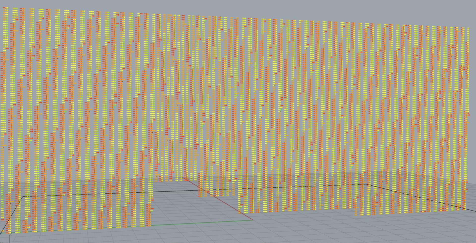

This was identified as a breaking change introduced by a McNeel update, see here. Once McNeel fixes the bug, this should work again.

Hi @eddy3d , do you think there is a workaround until McNeel fixes this issue? It seems like a mismatch in the mapping of Probing, between the output Probing Points and Probing Vectors
here the visualistion of simple wind analysis. May we can in the meanwhile remap the points or vectors??

I’m struggling to follow what the issues are here. Probing works for me with Rhino 8.8. Could you please post your issues here in separate threads including your Rhino and Eddy3D versions?
