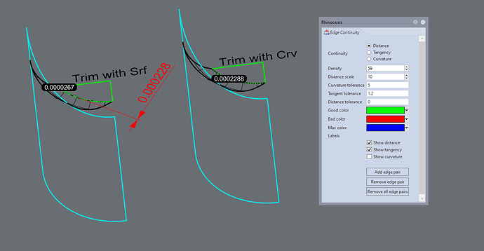

The real issue, as far as I can see, is how Rhino reports Edge Continuity seems to work depending on the method used to create the edges.
It has always seemed to me that whenever you trim with a fillet (as in the video) Rhino always creates Pollyanna numbers for edge tolerance. What I mean is that how can the edge of the fillet get any closer to the surface that it is on just because the user changed the tolerance before trimming? And even more wondrous is how can the tangent continuity improve tenfold by the user changing the tolerance?
I can see how the positional tolerance can improve depending on the user tolerance when both surfaces intersect fully. In theory, if both surfaces carry on past the intersection then you can refine the intersection curve be as accurate as you want. But when one of the surfaces is a fillet that surface was created with an edge a fixed distance from another surface. You can’t make that edge any closer or farther from the surface by running the split command. How does changing the tolerance make the distance of the edge to the surface any different? How does changing the tolerance improve the tangent continuity?

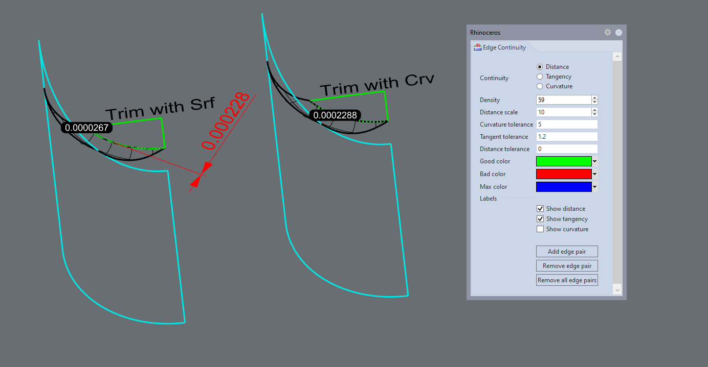

However, That doesn’t change the point I was making. What I was saying is the numbers you see EdgeContinuity reporting in the video are bogus. The actual distance that fillet edge is to the green surface being trimmed is much greater than EdgeContinuity is reporting.
This inaccuracy in edge tolerance creation occurs when trimming is done by using the fillet surface as the cutter. If the user does the trim or split with the edge curve then EdgeContinuity seems to report a result which accurately reflects the actual distance that edge is from the surface.
In the above picture the Red dimension was created by pulling the edge of the black fillet to the green surface and then adding the dimension at the point where CrvDeviation reported the maximum.
Notice when trimming with the edge curve you get a set of edges that accurately reflect the best edge possible for both surfaces.
When trimming with the surface the edge tolerance becomes a fictional number that paints a more rosy picture of the accuracy of the two edges than actually exists.
