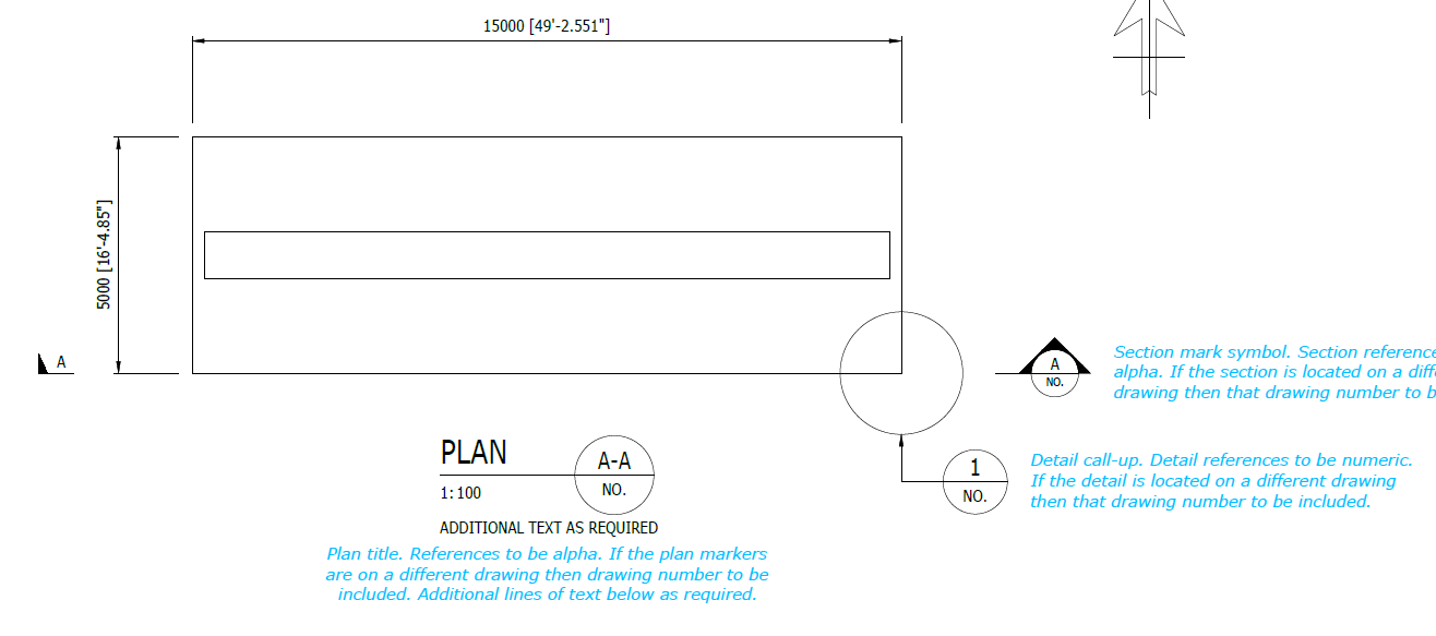

Hi everyone,
I am wondering if there is a straightforward way to do annotation with dual-dimensions (in mm and inches) in Rhino 5. I’ve attached the image showing what I want to achieve. Hope there are some good ideas.
Thanks ! !
There isn’t a feet and decimal inches alternate unit setting in Rhino.
That’s not a commonly found unit combination particularly at the detail scale you’ve shown.
Surveyors generally use decimal feet.
The closest we have is Feet & fractional inches but you probably discovered that on yourself.

The drawing is actually from the engineer we partner with. We will report this issue to them.

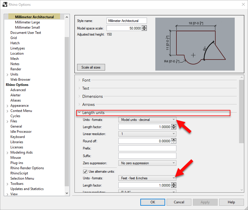

I see that the discussion turned to formatting the imperial units while your original question was:
Just in case you actually just want dual-dimensions like this mm [inch], you can do that by setting the Alternate text in the annotation style:

Rhino 6 has some improved drafting features: rich text, annotation styles, Rhino PDF writer, and baseline dimensions and the typical layouts, linetypes, print widths.
Rhino 5 is not as sophisticated as Rhino 6, but it does have some Alternate Dimension setting in the Dimension style.
Rhino 6 has alternate Length units that are part of the style or the dimension properties for overrides on specific dimensions. In Rhino 6 you have more control over the primary and alternate length unit display and formatting, than Rhino 5.
We can do a dimension with the primary unit as Decimal MM and the alternate unit as Feet-Inches Fraction.
floor plan with alternate dims.3dm (193.8 KB)
However, we can not do alternate or primary unit with Feet-Inches Decimal. This is an oversight. I am logging the bug ASAP and I will post the tracking number here soon. I guess we never thought that decimal inch used with with Feet & Inch. This is so helpful to hear that you are looking for it.
See attached sample file.
Let me know if this works for you.
