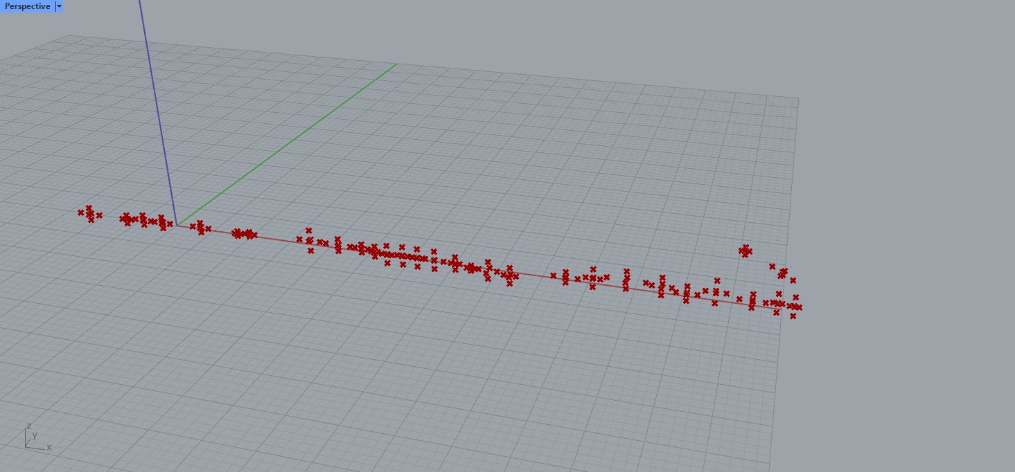

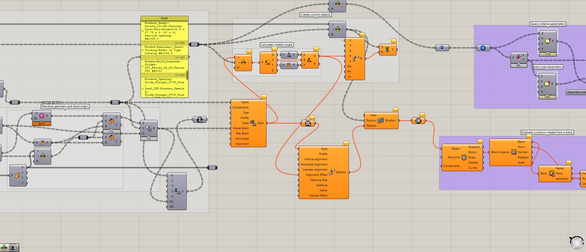

Hi @fsalla, I tried using the script changing the styles and components from columns to windows and it doesn’t recognize the names, although it is showing it in the yellow pannel as you can see in the images. I tried recomputing, but still not working.
@fsalla This is what appears in rhino window
I tried your script but unfortunatelly have the same problem as I had with Francesc’s fille. When I change the column style for window style it became orage without proceding the information, even though is being properly feed.
@fsalla do you know what is happening?
I tried changing the revit language to english, without success…Also tried deleting all other types, leaving only the windows, and still have the same problem.
do you know what might be happening?
Hi @Leo13 I’ve adapted the original GH file to bring Revit objects to VA to transfer windows that are exploded, and the resulting parts can be baked taking the values of a specific parameter from the Revit Window.
RevitToVA-Bake Window Parameters.gh (178.3 KB)
