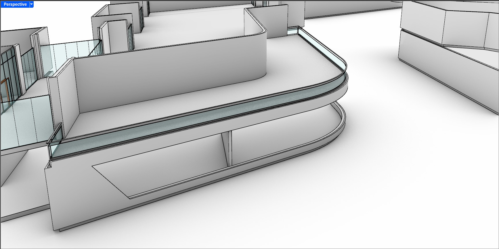

Hello .. I use rhino inside revit and when I use the file VAToRevit-Obj&Styles-1.1 to export to revit .. some objects can’t be editable like raillings .. and the walls that which have openings comes just solids without openings

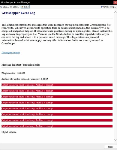

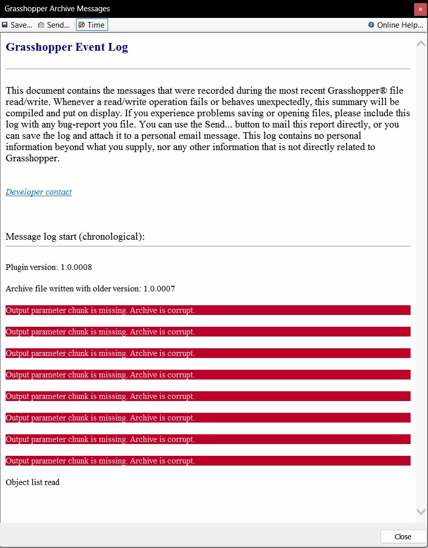

note: i get this massage every time I open the file (img)
