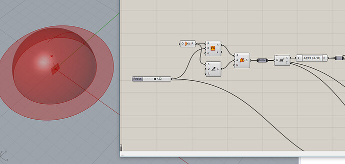

Thank you for answer. But I don’t understand exactly. I am newer on grasshopper. You said “Equal height slices of a sphere have equal surface areas” but I divide sphere with contour with same height and split it. And I checked the areas. They were different. In the second picture heights are different. I am confused. Can you explain more simply please?
Can you post a model showing what you did so we can help clear up the confusion?
Ok. I use contour to split surface. But areas are different.
LOL
Necmettin, I think you got us all.
Probably everyone (me included) here thought about a sphere, a spherical dome (every point at the same distance from a center point).
That’s what your first picture suggested.
But your second picture shows you are working with a generic, non-spherical dome.
If so, everything is different.
So, spherical or non-spherical dome?
for arbitrary shape you can use this brute force method :slight_smile:
same_area_dome.gh (63.2 KB)
(not as elegant as @maje90 solution)
Oo ok, I misunderstand that sorry. Actually its not spherical dome. You are right. I am trying to create Hagia Sophia’s dome like a masonry dome technique with bricks. This is my mistake sorry sir.
Actually sir, I created a dome with flat bricks. I searched a lot. And finally I did it. But on this model, all the elements (bricks) come to the upper elevations, they start to get smaller. I wanted to fix it. Because of that I asked how dome surface divide with same areas. I am trying to understand of main logic. I started simple sphere. But you are right. It is not a spherical. Firstly I create surface and later convert a mesh. This code works like that. I talked too much sorry. But this is the main idea. Thank you again.
