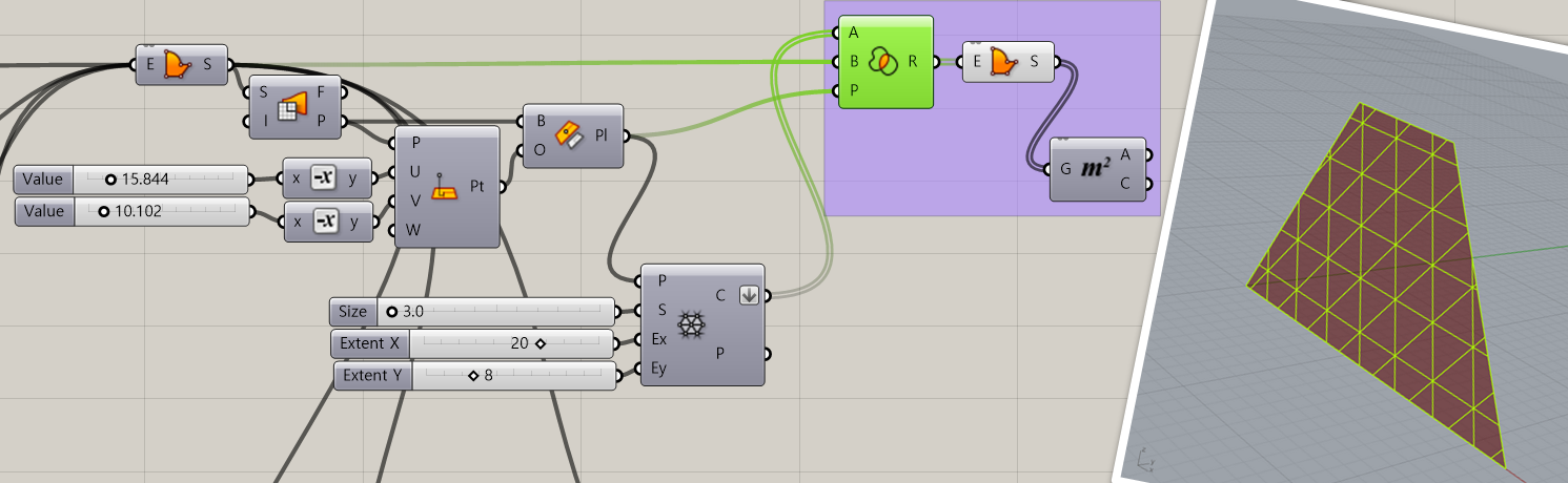

Divide a surface and get area of "sub-surfaces" without using the 'surface split' component
As described I would like to extract the area of each sub-surface that are created when a surface is splitted by a list of curves.
But the ‘surface split’ component is extremely slow -.-
(4.9 minutes when the length is set to 1 (in the example I have set the minimum to 3 so you dont get stuck))
So i hope that somone have a good idea of how i can get the area of each fragment without using the ‘surface split’ :slight_smile:
Example.gh (10.2 KB)
Best Silas

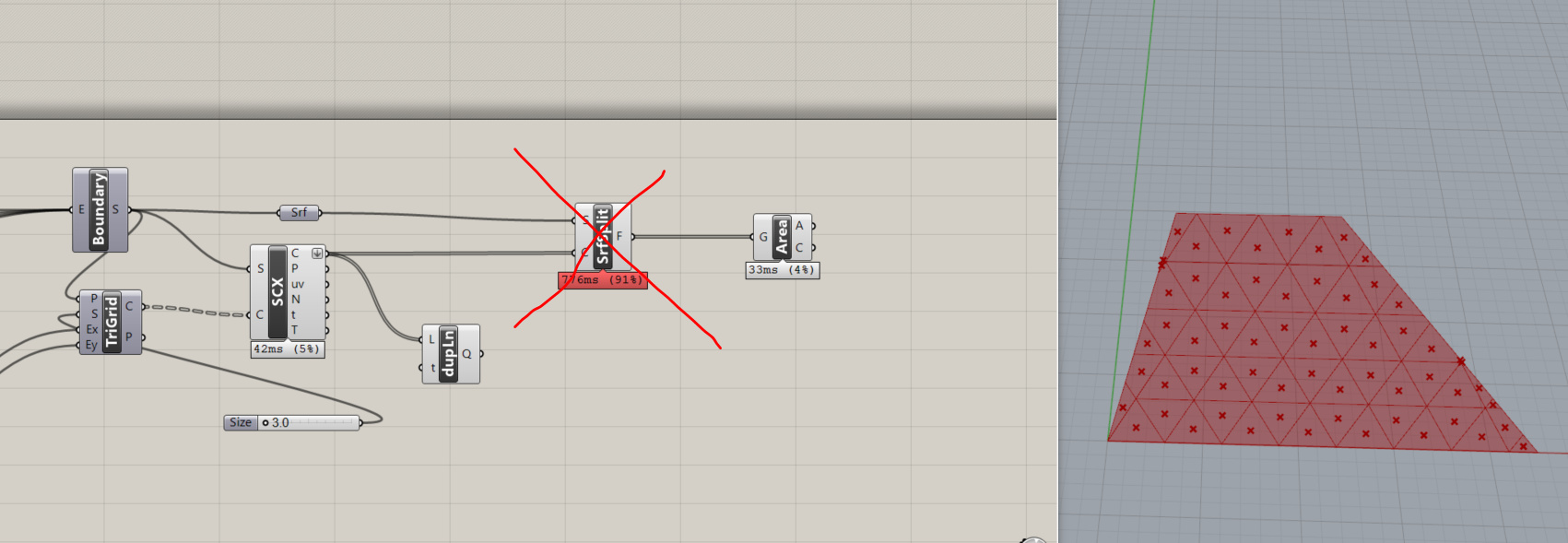

Have a try this way.
Example_reV1.gh (14.8 KB)
Thanks for the quick answer, it works a lot faster this way.

It is mostly the Region intersection that i slow and not so much the Boundary Surfaces.
That is why I thought of something like a mesh, because then there is no need to find intersections.
But thanks again
Never mind,
I’ll just stick to your first solution.
