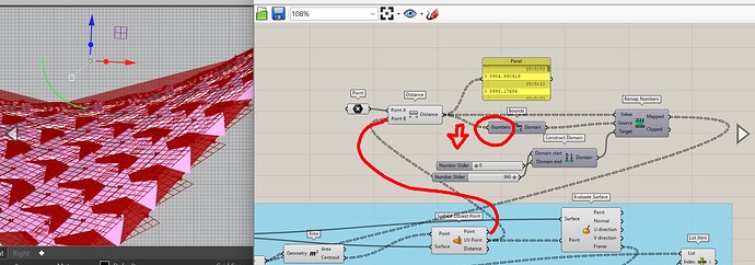

I want to use attractor point to vary the angles that triangles rotate at. but when i move the point around, the angles are not varying. i also tried flattening the distance and uv points but that made the surfaces weird.
looking at you screenshots only, the first thing that comes to my mind is to flatten the Bounds input and copnnect the Distance to the Point output, not to its UV coordinate

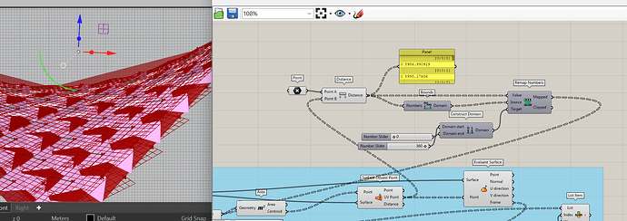

[edit] I confirm :
Grasshopper beginner 11h_inno.gh (239.8 KB)
