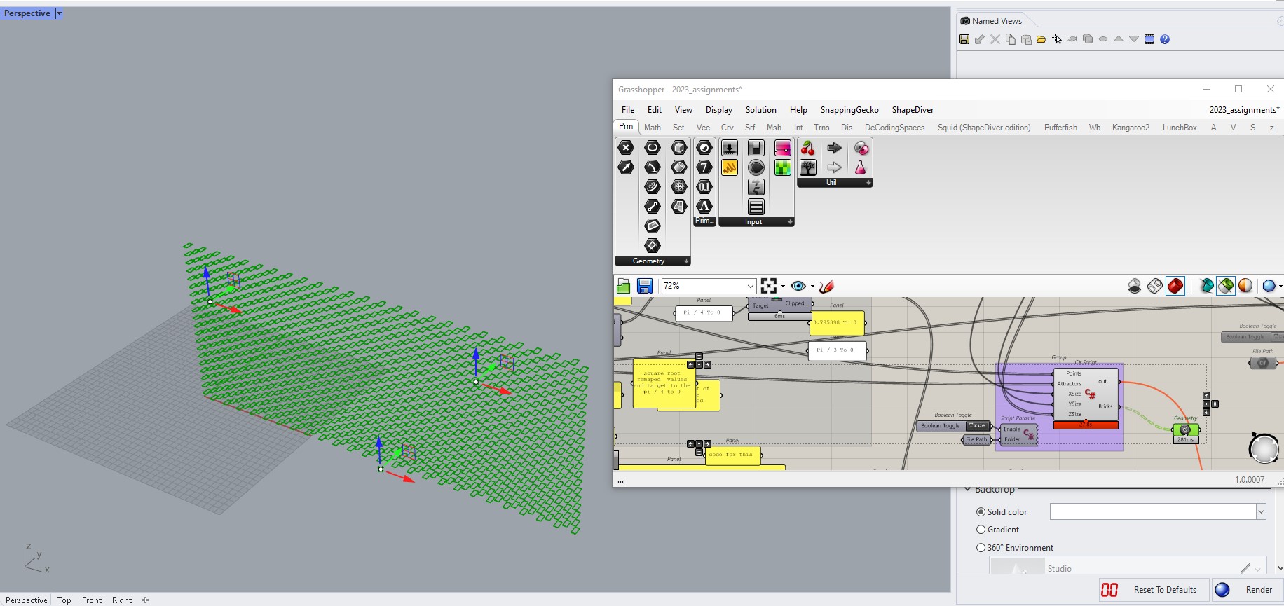

Hi I have a issue with the attractor input in my c# code. as in the first image the bricks are generated on the points and this is how it ought to look. the issue is when i introduce the attactor input to the component. the code is changing the brep geometry and not rotating the bricks by the factor remaped. is there soming i am overlooking?

@dale thank you for your reply. It did not work. Still the same result.
@Jacek4 - I didn’t ‘fix’ your code, just reformatted to others can read it…
ok thank you
See attached: get the gist of how it works and modify it accordingly in order to suit your goals (includes a not so simple challenge as well).
