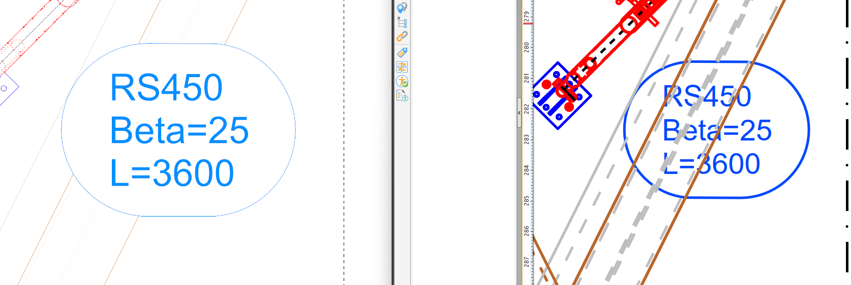

hi everyone,
when printing in display mode technical, text masks are getting lost:

Hi @Dominik_Wrigley-Simo,
I can see that it is printing with Raster but not Vector.
I logged RH-88317/Text-Mask-Not-Masking-in-Vector-Output.
We will let you know here when there is a fix.

You can use Raster output until the Vector issue is fixed
The updated driver will not solve this issue. It is just a good time to remind you to upgrade.
